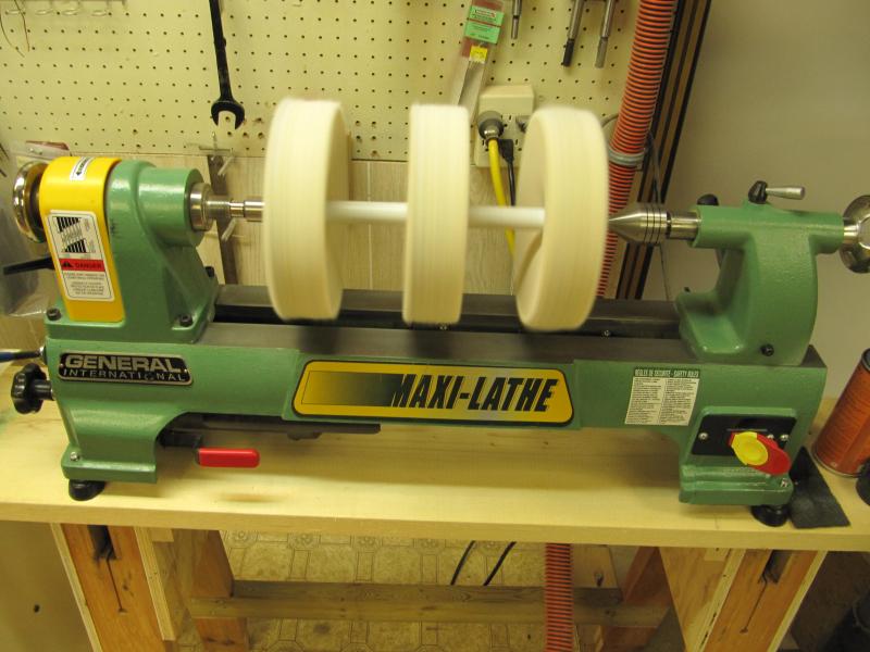

Here's a pic of my Caswell buffing system!
attachment.php
Each wheel consists of 3 Caswell buffs (maybe overkill) @ $5.00 per. So the buffs themselves cost $45.00.
To build my own cost the same as the Beall which I had at the time. Just wanted to build my own, only reason! The Caswell Formax buffing compounds beat the socks off the Beall Tripoli etc. My opinion only! Not looking for any arguments, but will answer any questions you might have regarding the Caswell, but not the Beall!:biggrin:
I use 1/2" bolts with the head cut off, 2 nuts and washers hold the buffing wheel in place. I use drill chuck in the headstock and the live center in the tailstock. The pressure from the TS keeps it in place. 3 bolts, 6 washers, and 6 nuts, cost less than $5 for all 3. Then add in the cost of the buffing wheels, compounds and wax.
I also made up extra wheels that are dedicated for steel polishing, plastic polishing, and polishing brass.

Hello Ron; I mentioned in one of my 1st posts to this thread how I made my Caswell buffing system. There is such a thing as a stub arbour in whatever MT you require. See here http://www.busybeetools.com/products/STUB-ARBOR-MT-2-X-1IN..html
It requires a hole drilled and tapped to fit the 1/2" all thread rod. The other end of the all thread rod can be centre drilled at 60° to fit in a live centre.
Put your buffs on the all thread rod with spacers between them and a nut and washer at each end to hold them in place, and you are good to go!
Hope that helps, if not and you would like more info, pm me with your email addy and we can discuss further that way!
