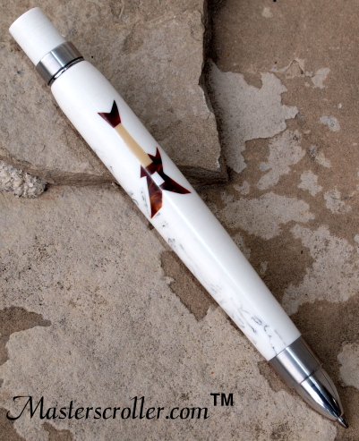

Punk Rocker style guitar on a finial twist Parker style pen. :biggrin:
I upgraded most of my Parker style pens to the Private Reserve refills. I noticed when I was making this one the refill kept hanging up somehow. Took me a while to figure it out..turns out the tape around the refill that says Private Reserve gets hung up on the edge going into the tranny. I noticed then a few other pens also have this problem when swapping out the refill to the better brand. Some are fine, and some require using an exacto knife and pealing off about 3/4 inch of the sticker at the top of the refill. I think in the future I'm going to start running a deburring tool on all my tranny couplers and see if that fixes the issue.
