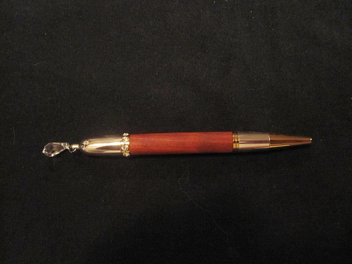

I have turned one of them......not a seller or a personal favorite. I cant remeber any issues with barrel fit, I used the bushings PSI provided.

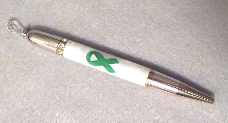

Stephen ---
i also made one (for my wife, kidney cancer) ----
----- the diameter of the finished barrell is 0.456"
Joe
