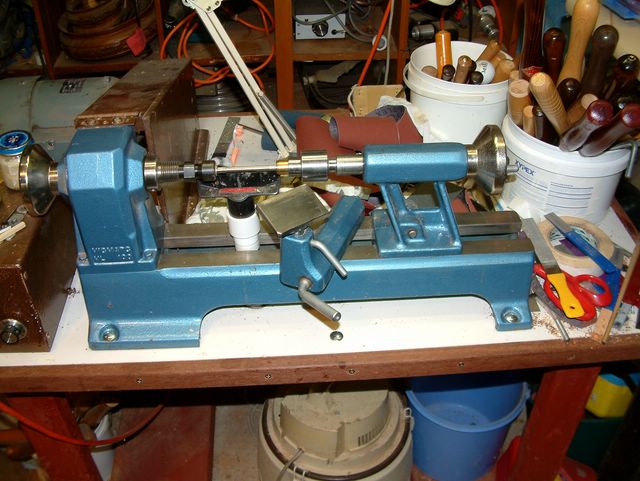

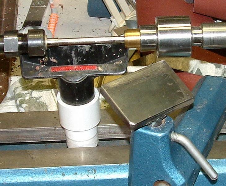

Perrennial question but for mine I have stated here so many times over the years using a Collett type 2 morse taper holder in the head stock (see recent U Tube video as used by ED Brown I then use a removable centre live centre insert a brass sleeve with a snug fit to the mandrel in use as per pic. Works wonders for me over a long period of years.
I like a mandrel the blank is captive, I like also the idea of between centres but continually read here of runaway blanks for various reasons, not good for that one off rippere I tend to use. I remember for many years advocating 1/2 a pen at a time also heavily criticised.
Have fun I do.
Kind regards Peter.

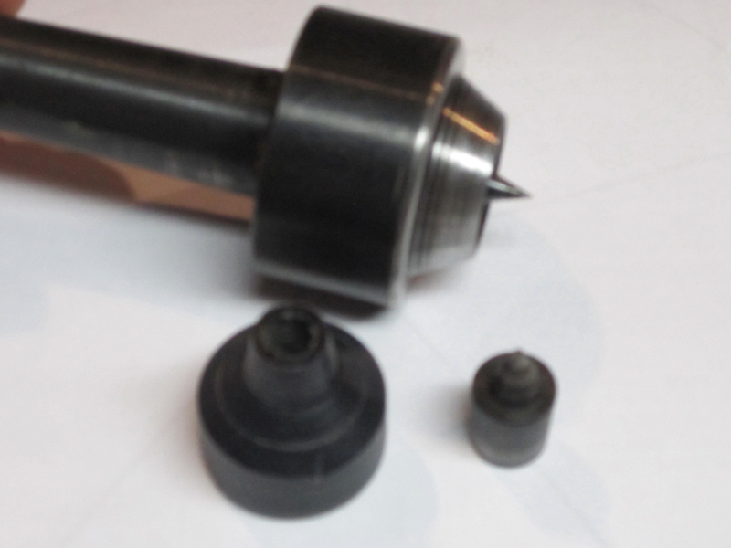

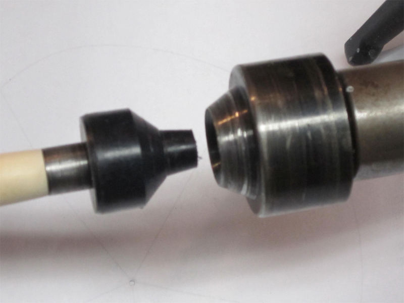

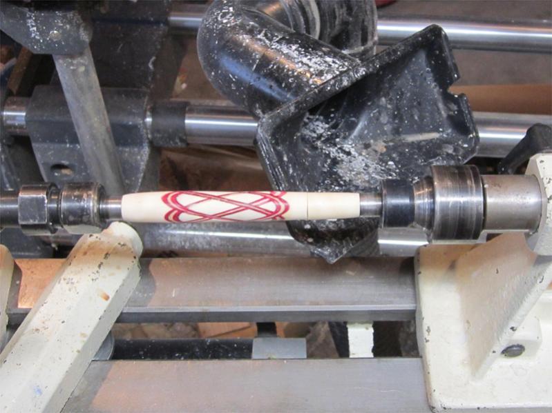

Along the same lines...I used UHMW Plastic. I have it for making finishing cones and drive centers. Knocked out the tail center and turned it for a press fit...Center hole is 1/4". My cost about 50 cents and 30 minutes..
