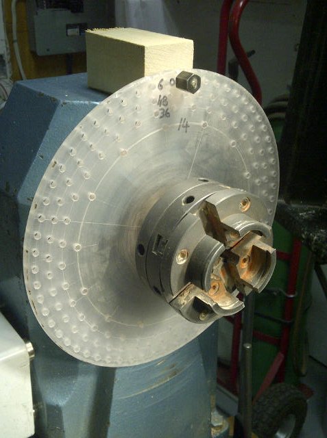

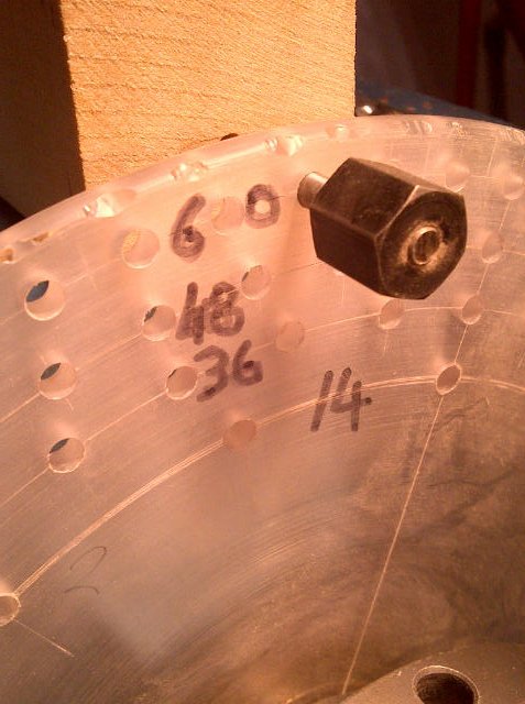

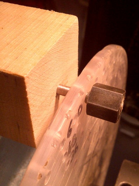

lorbay Member Joined Jul 2, 2009 Messages 3,391 Location BC. Canada Sep 28, 2011 #6 OK here are some quick and easy ways to make this indexing jig. The 1st is one I made for my Nova and then had to build up the base to fit my Vicmarc. Attachments IMG-20110928-00038.jpg 47.8 KB · Views: 381 IMG-20110928-00039.jpg 45.7 KB · Views: 262 Cowichan Valley C-20110928-00040.jpg 49.2 KB · Views: 247

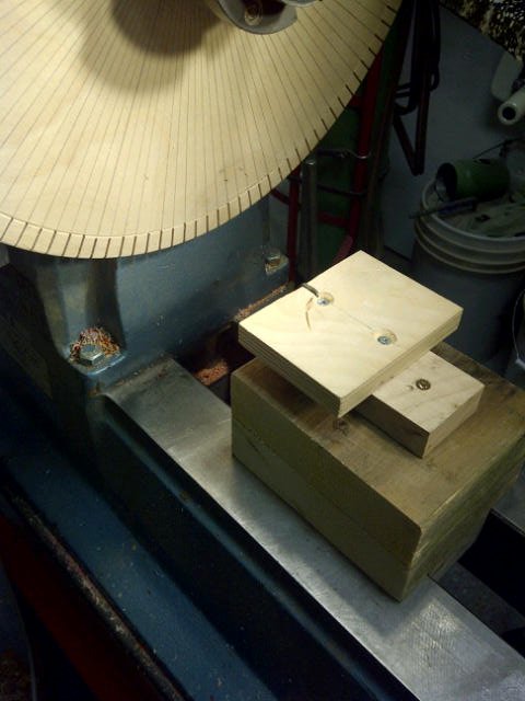

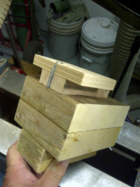

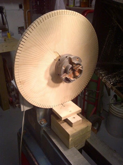

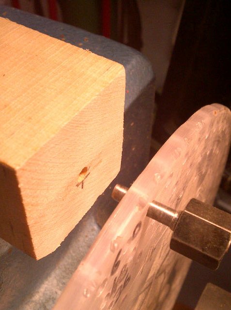

lorbay Member Joined Jul 2, 2009 Messages 3,391 Location BC. Canada Sep 28, 2011 #7 Then came this one that had some specific range of holes I wanted. The top block attaches to the top of the head stock for the pin. Lin. Attachments Cowichan Valley C-20110928-00044.jpg 55.4 KB · Views: 253 Cowichan Valley C-20110928-00043.jpg 49.6 KB · Views: 211 Cowichan Valley C-20110928-00041.jpg 53.9 KB · Views: 241 Cowichan Valley C-20110928-00042.jpg 48.2 KB · Views: 230 Last edited: Sep 28, 2011
