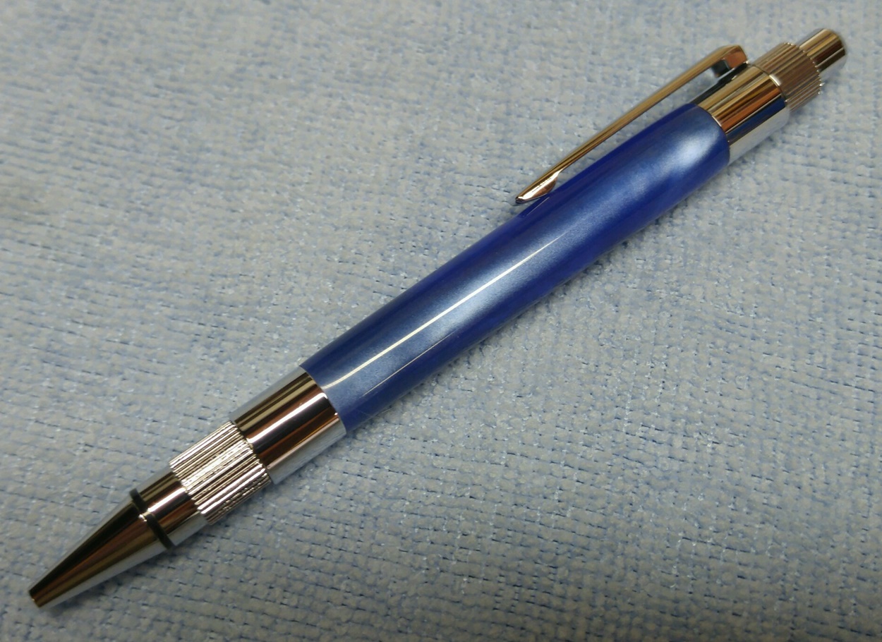

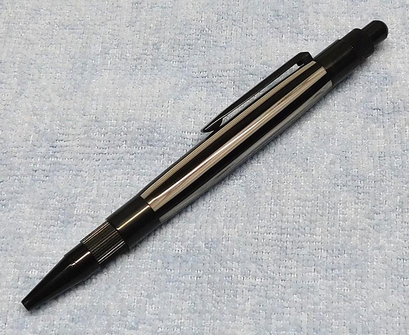

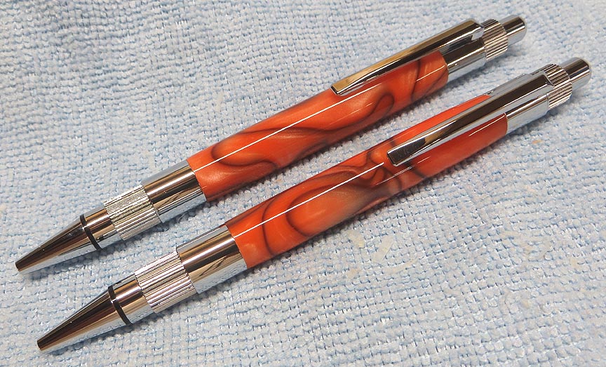

I've made a few as gifts, and also kept a couple. Haven't heard of nor had any problems.
