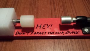

I had that problem a few times. This is how I remedied it:

You can remove the finial if you have a disassembly kit. Take one of the rods that is slightly smaller than the inside diameter. Remove the plunger and insert the rod about 1/4 inch into the back of the pen. Grasp the finial with your fingers while holding the rod and GENTLY wiggle the rod side to side and sometimes you can slowly work the finial out of the pen without damaging the click mechanism. Sometimes it works sometimes it doesn't. I have made many of these kits and have occasionally had to disassemble them for one reason or another. They are a touchy kit with very small tolerances, leaving little room for error. I hope this helps.
