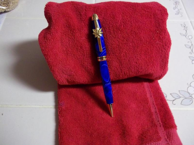

Don't I feel stupid! Arioux I hadn't taken the time to look at the assembly part of the instructions. After reading your reply I turned over the instructions to the assembly part and there it was! Thanks for the post. I'll be reading more through next time. BTW the part I parted off was short enough for me to cut off the tube re square the end finish and assemble. I'll post a pic in a few.. Thanks !!!!

Mach I agree with you on that. Here is a pic of the mistake pen.
