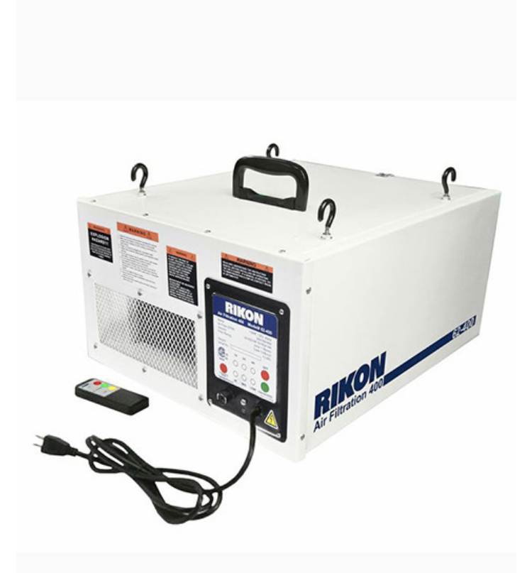

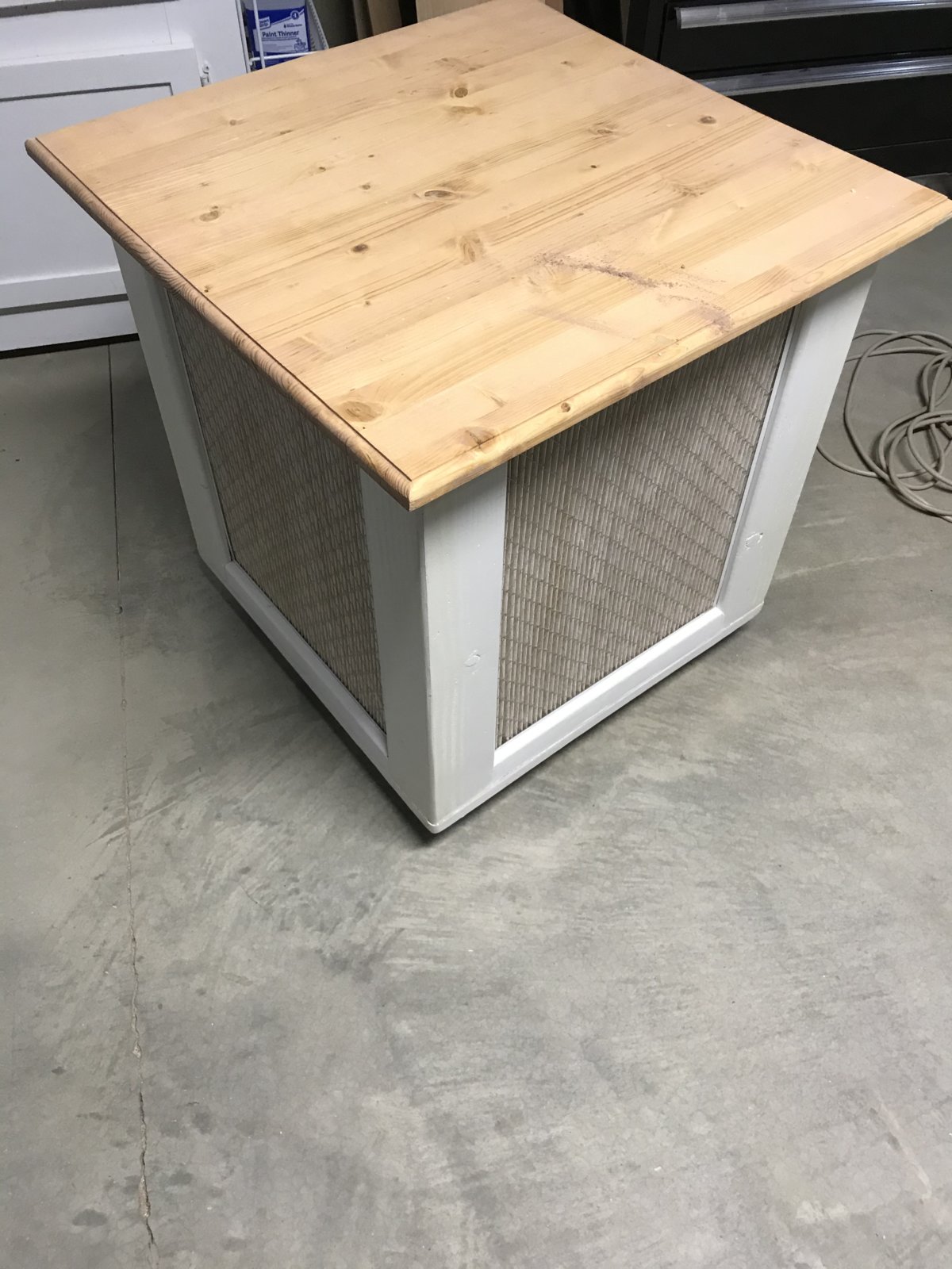

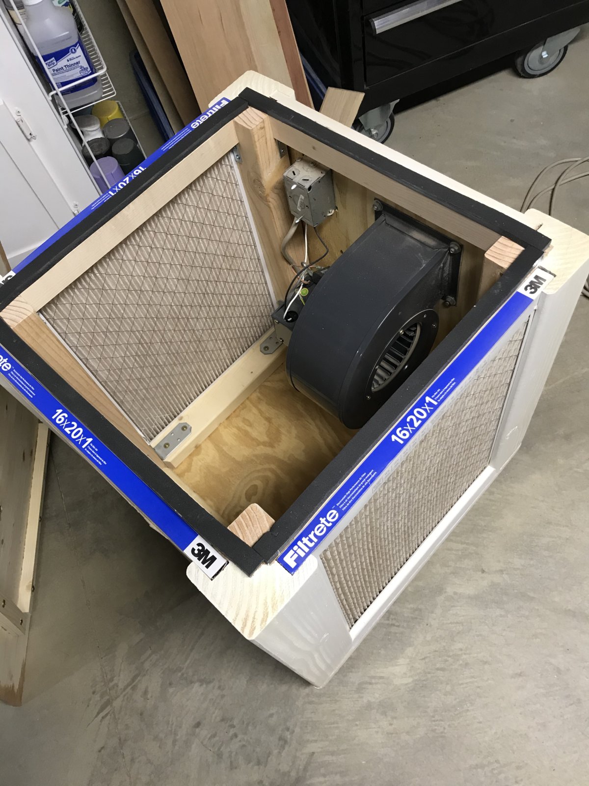

I have a small basement shop too. I have a dust collector and two air filters one of the air filters I built myself and it actually works very well, they all actually work great.

I've had a couple of different stand alone dust collectors that were 1 1/2 hp, with a Delta being my present one. As far as I can tell they pulled air about the same so I'd assume the PSI would do about the same since it's the same HP. At the present I'm only hooked up to my lathe. I started running ducts to my saws and sander but have yet to finish. I did add an ceiling air filter recently and that's when I noticed a big change in dust collecting(see what I did there? [emoji16]) all over everything. I was lucky I was able to install mine outside under my the stairs along with my air compressor. If there's any way to do something like this you'll love not having to deal with all the noise.
