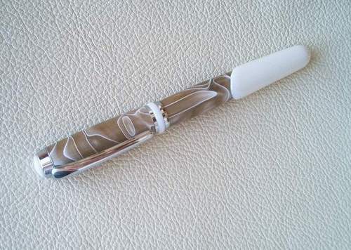

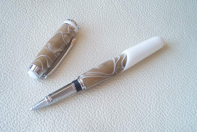

another that went to Provo
closed end Chrome Baron in acrylic and corian
On the Baron, the cb comes apart and I replace the black ring with one of choice material. The cap finnial must be drilled out and i make my own version using the same diameter of the choice material. It is a rather small part and it is tricky to make the pin that is epoxied in the hole the original came from while keeping the diameter and thickness of the disc correct.I hand sand and polish after parting..
Glenn, I really love your pen! It is beautiful and with the material used looks very graceful.
