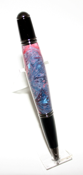

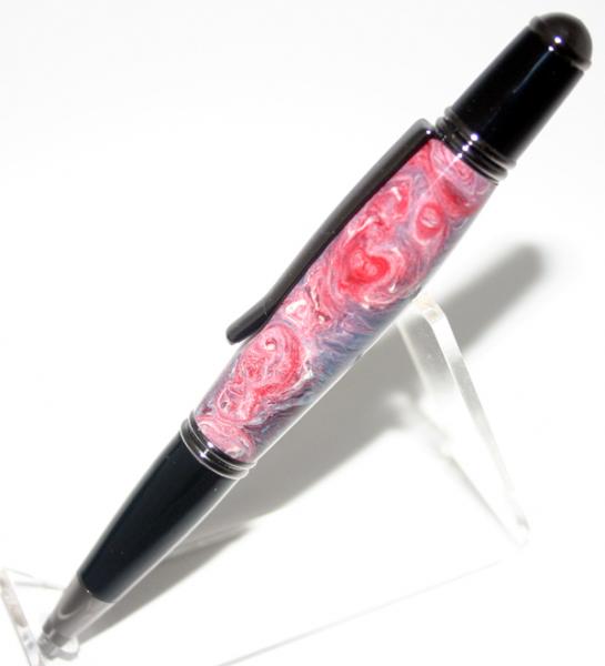

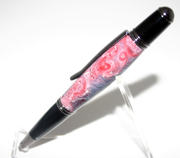

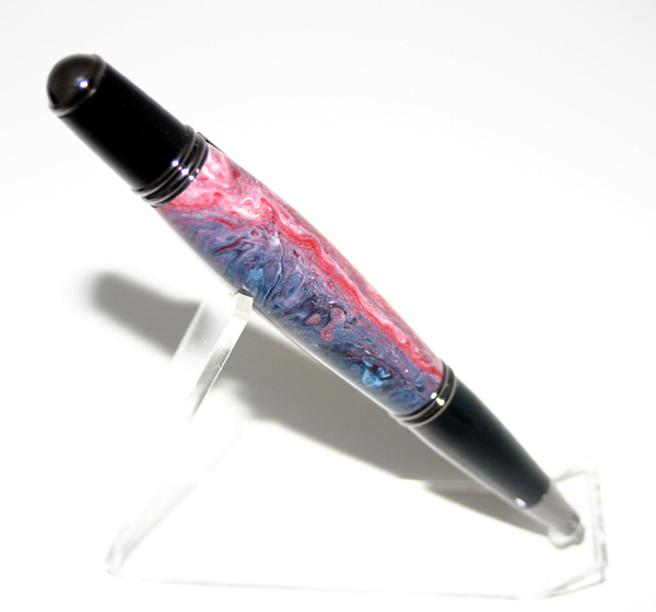

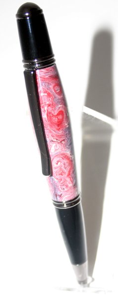

Okay - a little late for fourth of July :biggrin: This Gatsby pen is made from a mold I cast with red/white/blue model paints and resin. Yes the paints you paint your model cars with. I have another thread in the Casting and Stabilization section for further reading on that experiment :smile:
The only thing I don't like is how the white turned some of the red pink :rolleyes:
The photos don't do it justice but there is no purple, just pink lol
Anyway - here she is!

Pretty neat looking pen. The red turned pink and the blue settled to the bottom of the mold, or vise versa, because you didn't wait long enough or time your cups right. It's tricky, because in order to keep colors separate, the resin must be gelling so when you pour them together, the different colored resins flow around one another rather than mix together. Also, if you pour too early, if one color is heavier than another, the color will sink to the bottom and you'll end up with a layered pour. The difficulty is that some colors can gel much faster than some others, especially with PR. So you need to know how long it will take. I find that white always gels faster with alumilite, but no matter what, everything will be gelling within about 4 minutes, so I stir other colors first and white is the last cup stirred. With alumilite, once you pour there's not much else you can do, but cap it and pressurize. With PR, when you pour during a gel, the colors will stay separated but they will still swirl around, yet the swirls will be fuller, and if you want the swirls to be finer, then you can stick in a Popsicle stick or some tooth picks and stir things up a tiny tiny bit, just enough to create finer lines in your swirls.
