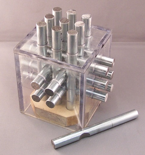

This is my first puzzle and I'm now hooked:biggrin:
This is a working prototype for a swap on Eagles site. It has 19 x 12mm MS bolt shafts interlocked inside a clear polycarb box. Now that I know it works, I will make a solid block from wood or probably PR and copy the shafts using stainless steel bolts. The shafts are removed by rotating or pulling some to release another. It was fun to make, but I have blisters from filing the notches in each shaft. I only used a hacksaw and a half round file to make it. :biggrin: The spare ( mistake ) shaft in the foreground shows the round notch.

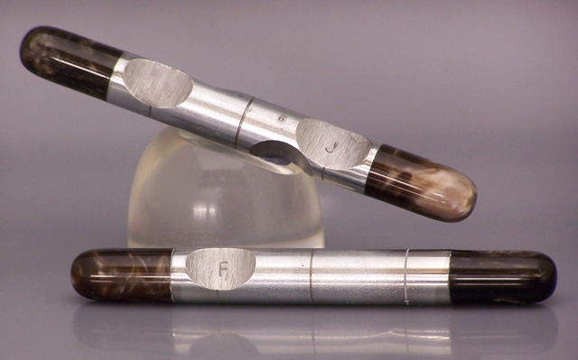

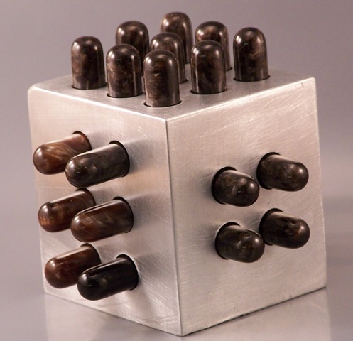

Eventually!!!!!!:mad: Just need some polish for the aluminium block and it done. These bolts drove me nuts!!!!! :biggrin:
I didn't use Stainless after all, but trimmed the ends of the MS rods with PR instead. The rods were trimmed from 12mm to 6mm at the ends to reinforce the PR. The rods are stamped incase the new owner wants the code to rebuild it.
This puzzle is up for grabs if you know where to look. Nudge nudge,:wink: :wink:
