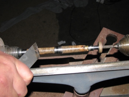

A sharp skew chisel held of top of the pen provides a delicate cut that is easily controlled. Just put the edge perpendicular to the pen blank and then roll the tool gently until it starts to cut. Imagine if it were a knife blade making a slice, not a scrape.

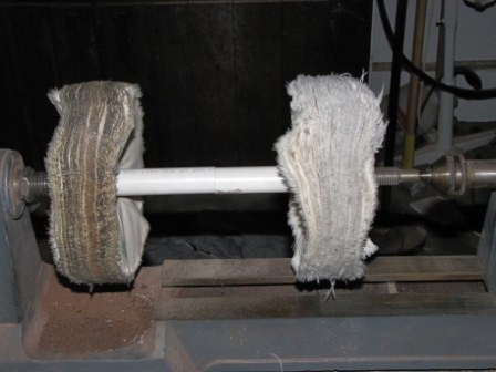

I also bought a buffing wheel for my lathe. When I turn acrylic, I sand to 360 grit and then let the buffer do the rest of the work. It works perfect every time.
Just my thoughts. Attached is a picture of the skew chisel and buffer.
