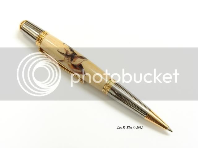

Who saw some of the ones I had at the last gun show that had a Pronghorn with a rifle.

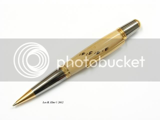

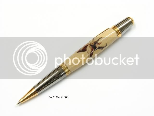

He wanted one with Pronghorn tracks instead of the rifle on a Black Titanium/Titanium Gold Twist Sierra.
Turned a piece of curly maple to .001" smaller than Sierra fittings, sanded to 400x, buffed with super fine steel wool, applied 2 coats of MINWAX Water Based Oil-Modified Polyurethane.
Applied decal, applied 4 coats of MINWAX Water Based Oil-Modified Polyurethane.
Cast in Polyester Resin, turned to fittings diameter, sanded to 400x, buffed with super fine steel wool and polished with Huts Ultra Gloss.
