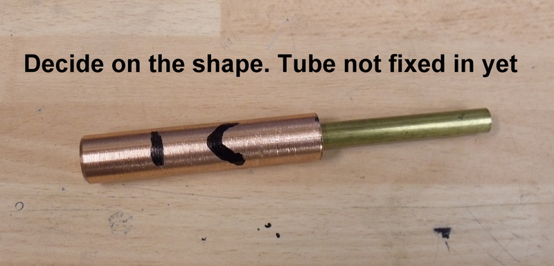

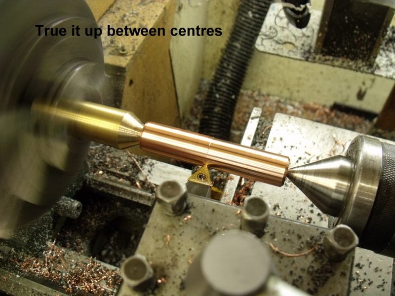

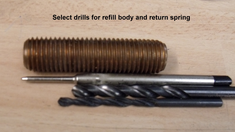

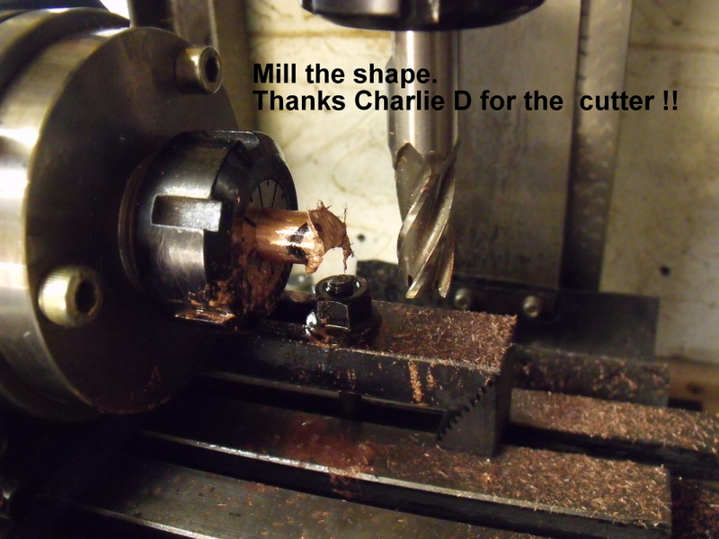

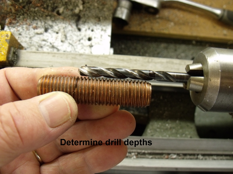

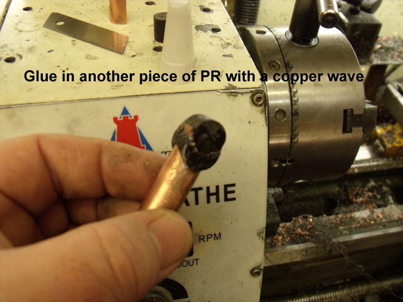

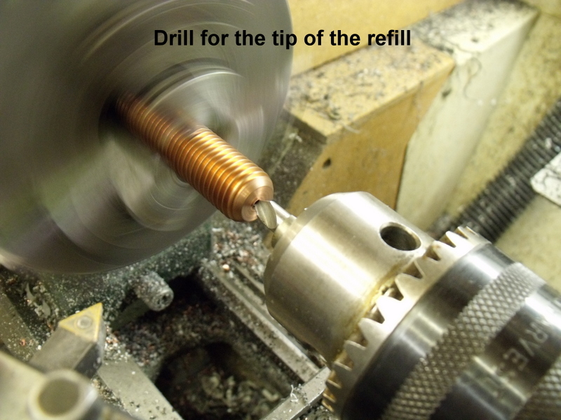

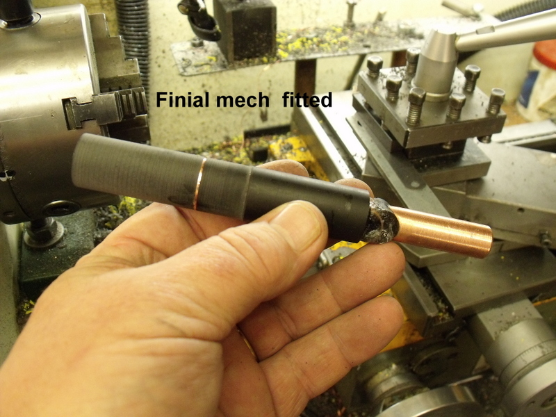

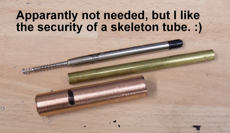

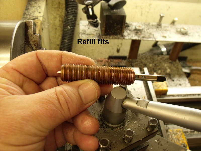

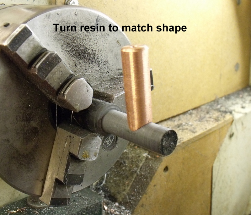

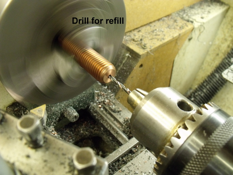

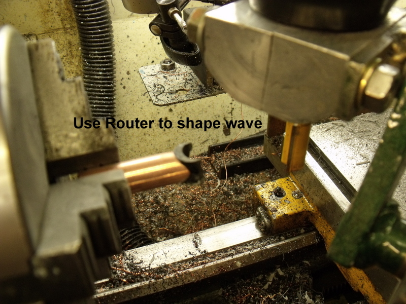

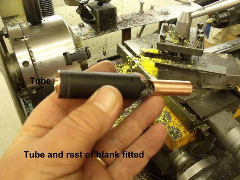

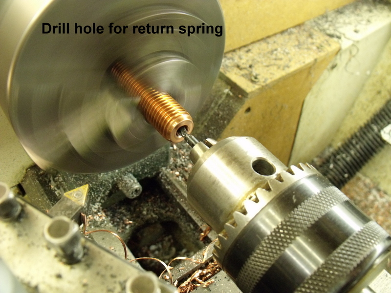

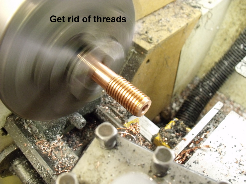

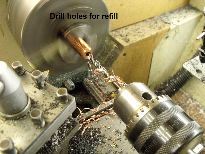

I just finished a pen that I kinda like. I sort of made it up as I went along and took pics as I went.
The pics are in numerical order and should be self explanatory, but please ask if you would like any explanation.
Hopefully it will be of interest to someone thinking of going down this route.
I'll post pics of the finished pen in SOYP shortly...:wink:
Cheers:biggrin:

John, I have no idea what grade it is. :confused: It gets pretty gummy but a squirt of lube with light cuts seem to work for me. :wink:
In picture #9 you have it between centers......That I can see.
My question is the drive center (on the left) in a chuck or is it an MT2?
Is that made just for a metal lathe or can they be found for a wood lathe?
Great group of pictures. Makes the process much easier to understand.
(Still think you use magic between the photos.)
Wayne, it's a sacrificial drive centre. Just a straight brass rod. I hold it in my Normal chuck and give it a quick light cut at 60deg to make it central each time.

Chuck, maybe these threads show it clearer. I showed how I make them in each of those threads. The 'wave' is actually an illusion as it is of course just an arc, or semi circle. :wink::biggrin:

Thank you Steven. I didn't actually forget about these other beauties I....just didn't remember them. :biggrin: They are a big help with the photos. I need to see if my router will line up with the center. I thing it will.
Question! Do you roll the brass sheets with your fingers? Or....a pasta roller or, some other precision device I'm unaware of :redface::smile:
Chuck, just by hand. I bend them around a smaller diameter rod or drill bit and they spring back a bit bigger. I may have used a 14 or 15mm drill for those.:wink:
