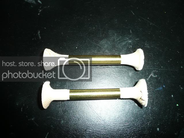

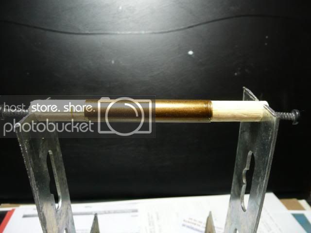

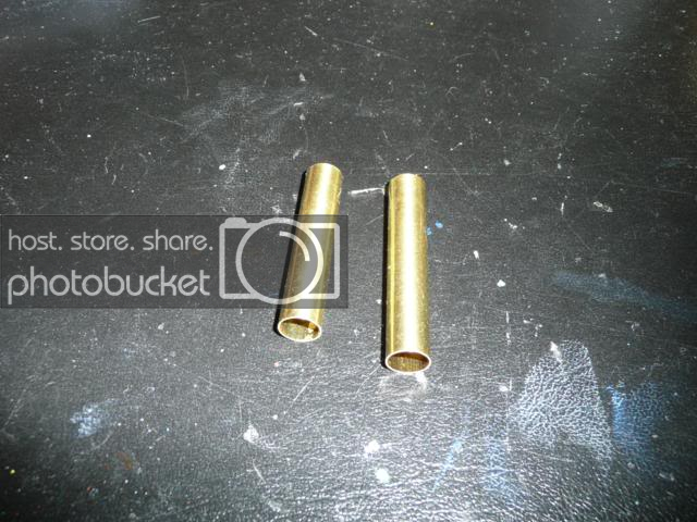

Hello friends, I have been thinking of making a pen with peacock feathers and on this occasion I started to work. Little by little I'll put pictures of the process, start by placing some wooden blocks at the ends of brass tubes to prevent entry when making resin casting polyester resin.

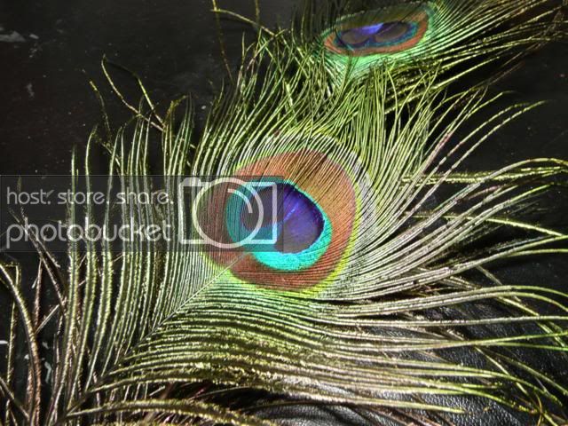

Select the desired pen, in this case we use the feather eye

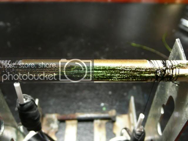

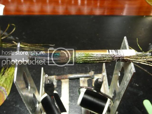

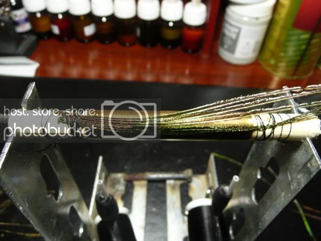

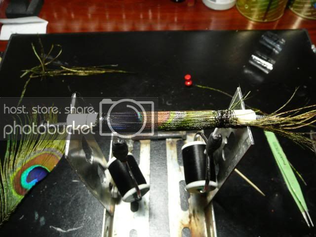

little by little we are sticking around the tube pulma joining the ends with a drop of cyanoacrylate glue and wire stringing

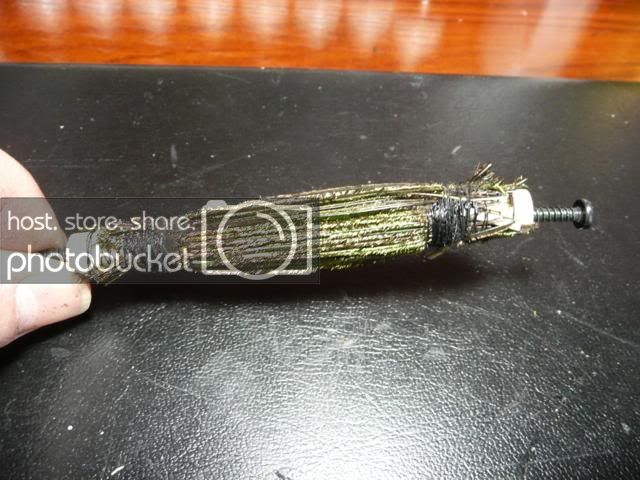

Once finished the bottom of our model of pen "Cigar" will do the same process with the top

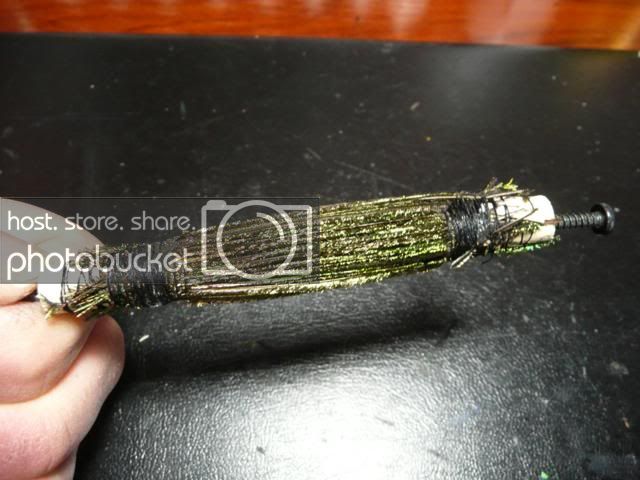

It is this aspect once the process of gluing the feathers must now prepare for casting polyester resin, which will be later.

Good luck Alfonso. Looks like your on your way. I make a lot of feather blanks from a lot of different birds. Peacock are beautiful. I just wish the resin didn't darken them. Looking forward to seeing your results. John

There's already a tutorial on the library by Shane Whitlock on how to cast feathers. So far it looks like the same process.
