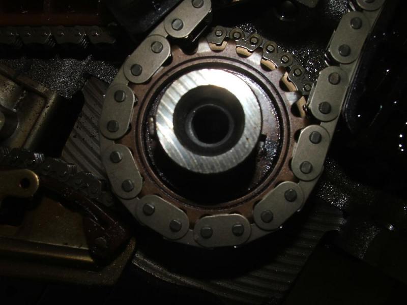

On 12/2/2010 my dad was driving to work, about a mile from our house the engine in his explorer shut down. He Brought it back to the house (pulled it back) and while trying to diagnose the engine issue the truck lost all power so we had it towed to the dealer. On 12/3/2010 the dealer looks at is and says they solved the electrical problem and after testing the engine it has no compression. But they cant explain why the engine failed with only 52k on it. They also stated the the truck is 12 days out of warranty. Yesterday, the tech at the local dealership said we need to call Ford headquarters about it and gave us a number. We tried calling the number and it was out of service... So we called anther ford dealer and they gave us a working number and person at the customer relations center looked up the truck and said all warranties expired and that there was nothing they could do, and refused to transfer to a supervisor
On 12/14/2010 we had the truck towed to a local auto repair center to have rebuilt engine installed
On12/23/2010 The work was completed and the mechanic called to have us bring a camera

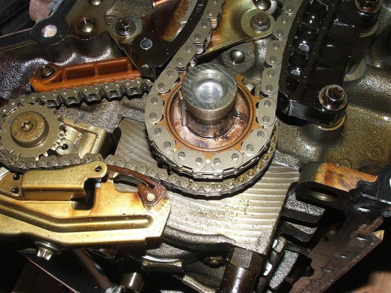

On 12/24/2010 we went to pick up the truck and the mechanic showed us the engine and said vibration dampener bolt that was not torqued which caused the crank key to strip and caused the cam to stop
On 12/28/2010 we called ford again with the mechanics findings and they said "our engineers have determined that all failures should occur within the first 5 years. so we are sorry but there is nothing we can do"
we bought the truck in 2008 with 17,000 miles on it when the failure occurred the engine had ~52,000 miles
Any Suggestions

The mechanic assumed the Balancer bolt wasn't torqued? Might be true, but there would of been a pretty nice vibration and would of probably came apart long before 52,000 miles. Also if the bolt had come loose the balancer would have just came off. The likely hood of the keyway stripping is very small. The keyway is still held in there by the crankshaft pulley that's connected to the timing chain.

He said all of the other engines he has worked on he has struggled to get this bolt off and on this engine he took it off by hand it should have been torqued and then 85 degrees according to the specs

the balancer (vibration dampener) has nothing to do with the cam stopping. The crank pulley is not connected to the timing chain/belt either. If the balancer did come off, it could have sheared the key. It would have been fairly obvious that it came off from the noise, and the accessories (alt., water pump, a/c) becoming in-op. from the belt slinging off. The engine wouldn't have just stopped, it would have overheated or battery went dead, but it would have still ran until that happened.
If the cam had stopped, it would cause some bent valves and pushrods and possibly piston damage. This could explain the loss of compression. No reason to replace the engine.
Without inspection and diognostics of my own, I can't speculate on the problem.

are both of the pics from the bad engine? Sure looks like the keyway is there in both of them.
