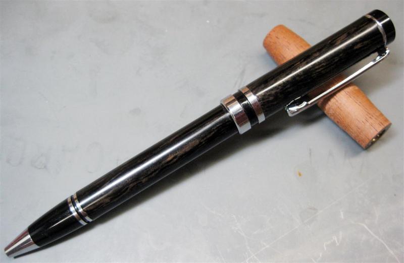

So I turned a full ebony pen for the first time. I've used it as parts of segments and not had a problem, but the full blank gave me FITS.
I've sanded and refinished this pen twice now and I just can't get a finish I'm happy with. I used Acetone to clean the surface and dry it and then CA over the top. I'm out of accelerator so I used CA/BLO but I'm thinking maybe the combination of the BLO and the oils from the wood hurt me in this case? I just can't seem to get an even glass smooth finish on it no matter how many coats I used or how much sanding/polishing I did.
I didn't clean the pen before these pics...sorry about the finger prints but looking for any ideas for the next time?

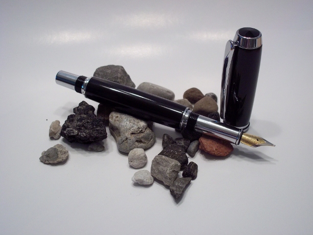

i've done a couple ebony pens. only with ca though. but like a black car they show everything, so i sand, lots of clear, micro mesh, automotive scratch remover, then wax. but make a mistake and you will see it.
:biggrin::biggrin: Sure will see it! But if making a pen to hurry and get through and show off, then that will happen. For me, a long time ago, I learned that each pen is a journey, some 30 minutes and some several hours or more. When the journey is over, most of the flaws are gone. And the journey is not over (to me) until then.
Good info all. I'm leaning to the BLO being the culprit in this case. I just didn't have anything else to use as an accelarent and was just trying to get this done and off the lathe as it was getting the better of my patience.
