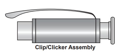

I've had that problem in the past too, but that's not the problem in this case. The white plastic mechanism is somehow jammed in the clip assembly. I think it has to do with the click mechanism spring. I can't pull it out. I've had that happen before with Vesper pens. I emailed Woodturningz, I'm hoping they respond soon.

Can the click/plunger assembly be disassembled? From the looks of the assembly instructions for the pen the click head is larger than the assembly body.
