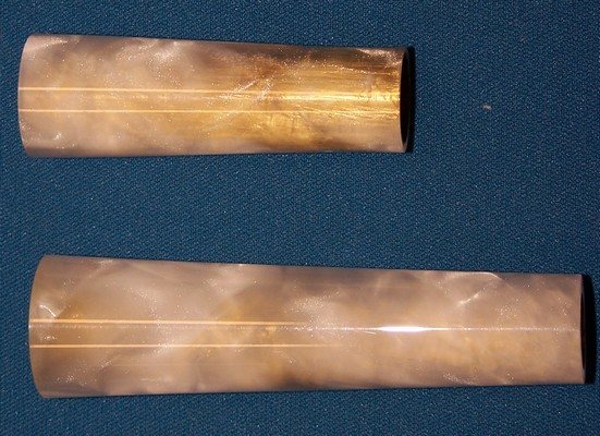

Hello
I am a novice French turner
And admiring of this magnificent site,
turners, And of their works.
J have a problem with a blank
"WHITE MARBLE celluloid"
Bought at "Craft Supplies USA"
In places he(it) is transparent
And we see the tube
C is normal?
Thank you for advance for your reponce
jean francois

Welcome Jean. Yes this is normal for a lot of acrylic blanks. A lot will paint the tubes or the hole in the blank or both before gluing the tube in. I use fast drying spray lacquer with success but others use fingernail polish or model paints or even markers to colour the tubes.

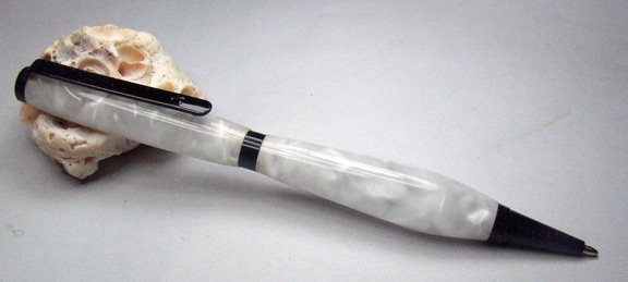

Jean. I turned one of these recently, and there is a picture in my photo album of it. I sprayed the tube with a white primer before gluing. Some of the paint came off with the CA glue, and if one looks carefully, one can see a small amount of the brass showing, but it is not very noticeable. It is a very pretty material, and my wife stole it immediately!
Might as well include the picture. [:)]
Your pens are magnificent.
Yes c is of the white
I am going to use some varnish has blanc.mais nails before he(it) needs that I rehearse(iron) a command(order)
J had that of it one.
Still thank you very much for
L interet that you have door has my probleme.
Jeans francois
Jean I've also done as Ron and Andy suggested with that white blank. I've also tried painting the inside of the blank different colors. It makes a very interesting effect. The best one I've done was painted a dark purple inside. With the varying degrees of transparency it made the pens have several shades of purple as well as white. My wife named it "Purple Ice"
