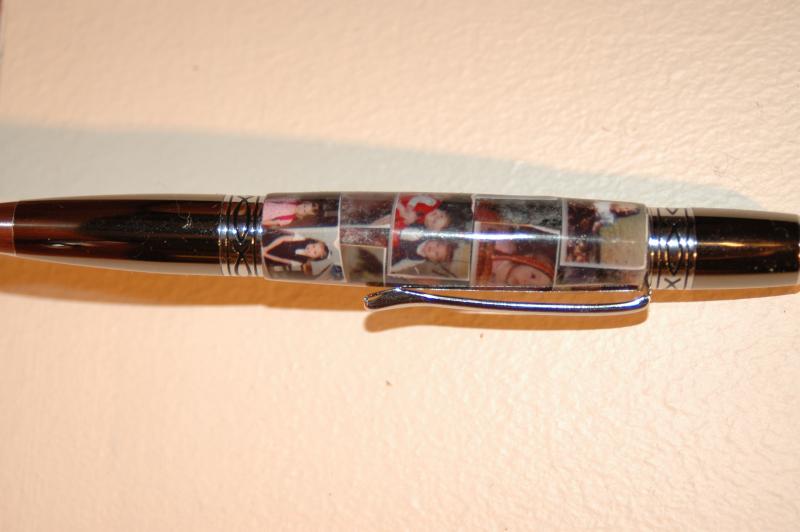

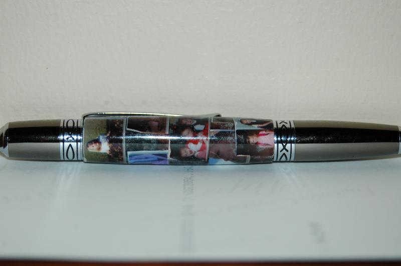

Update: Just completed my second collage pen for my dad. I'm going to wait until I get my photo tent to post a picture. Much better than the first.
tip: When you glue on pictures, use wax paper to keep pictures from sticking to fingers.
Gift for my father in law. Collage of all his granddaughters. His little princesses. He loved it.
Turned down a piece of wood a little smaller than required. Glued on pictures with med CA. (Pictures came from Walmart proof card.) Applied layers of med and thin CA until thick layer was achieved. Sanded from 150-600, then used plastic sanding pads. Finished with plastic polish and Ren wax.
What do you think? Has anyone else attempted this? Let me know.
Pictures of the pen are terrible. Should have photo tent in soon.
