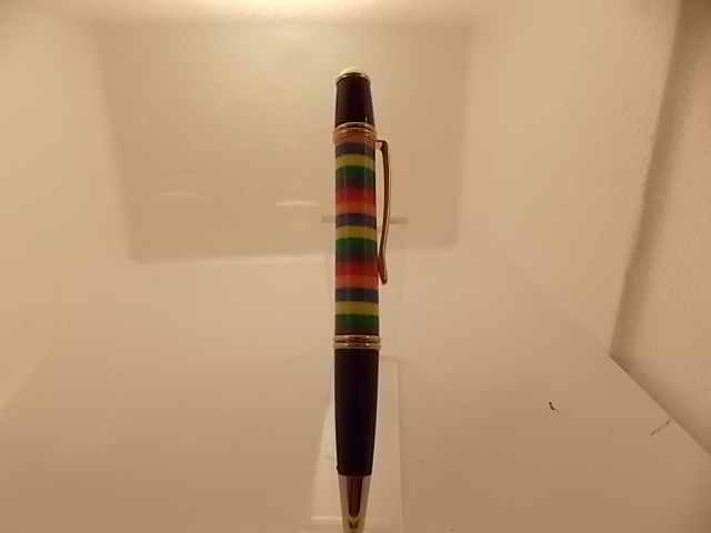

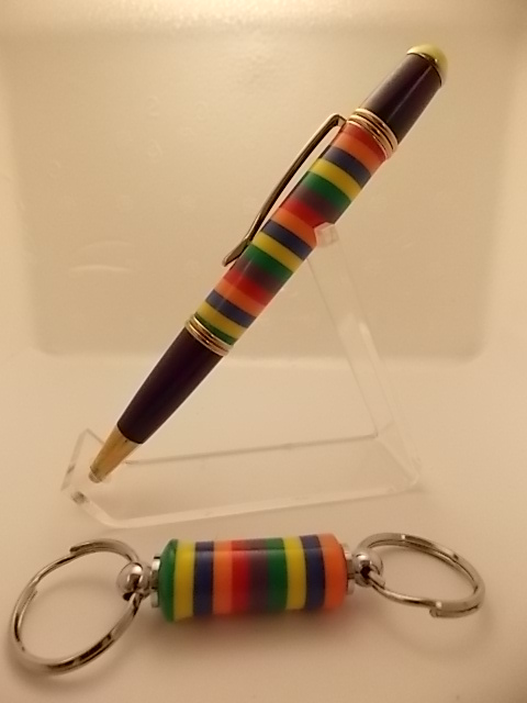

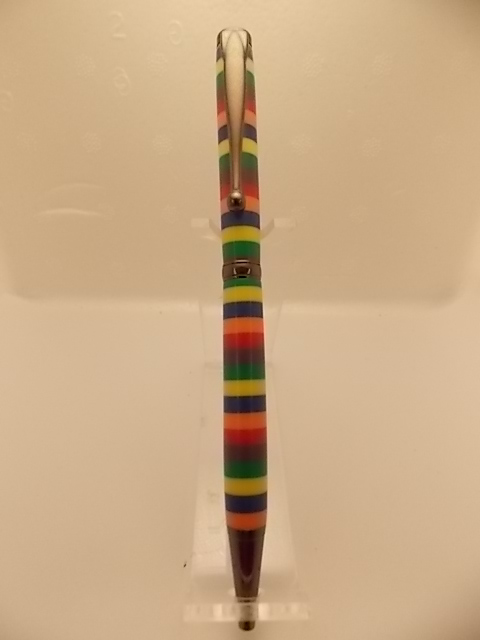

A lady at work ask me to make her 2 pens for PRIDE week 1 for her and 1 for a friend . Pride week was this week and she ask me yesterday afternoon around 3:00 I said will next week.... I got a yes... just made a key ring with left over blank ....I know its silver and the pen is gold..

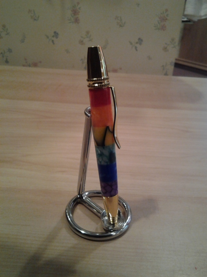

When I do them I custom segment my own blanks. Calculate the length of each of the six pieces to fit the components I'm working with. Then i glue them In order starting from the clip end
Red
Orange
Yellow
Green
Blue
Purple
After gluing I rough turn using a steb center. I find this cuts down on the delamination when drilling. Then in glue in the tubes, sand them square and turn as normal.
I'll try to post a picture later. They have been received very well. I also do keychains and mini styli.

thanks and I don't know.. years back I ordered a pen blank from someone on ebay and they sent it with 8 or 10 striped blanks they were all bent /bowed bad :eek:, I guess they were for me to play with :confused:.....so I did . I cut them in 1" blocks glue and clamped to make the blanks for these pens. :cool:
