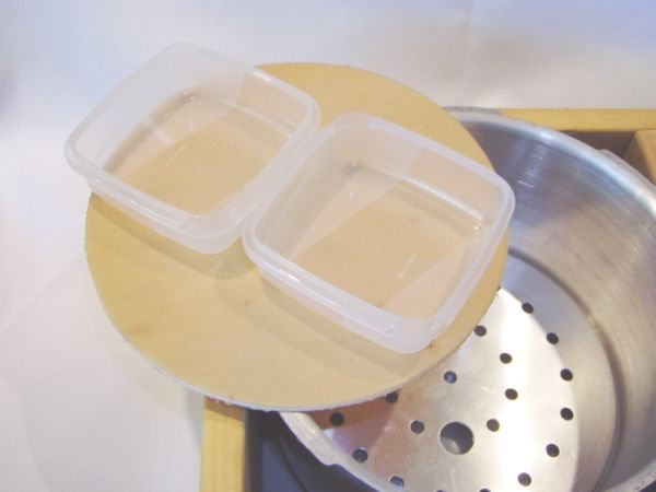

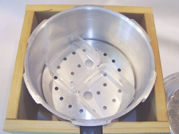

Non! only for pressurised I did one about 2 years ago, I think it make the start to the paint pot and pressurise casting, did have a good talk with Don ward at the time about PR and recomend me caution, well it work well for me and still does on small test, never the less I do have a HF paint pot Don find it for me and use for big batch, people here make it more versatile ( press-/- vacc )awesome.

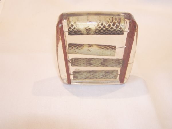

This is my first casting dated 23rd December 2005, since Don perfect it with the cork end who is much better I was using potato at the time [:D], first Australian sea snake Baron, PITH 2005, guess who got it[;)]
<br />

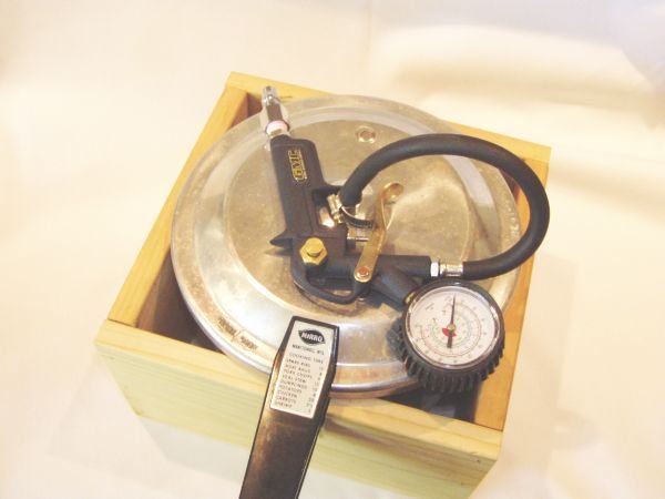

This is my pressure cooker ( note that is in a wooden frame )left one night in the work shop conected to the compressor next morning he was at 60 psi and puffed like a ballon ball tap was an answer, it can be done but like Don told me please be carreful, if you wanrt do a search on this site I think I post something early 2006
<br />
