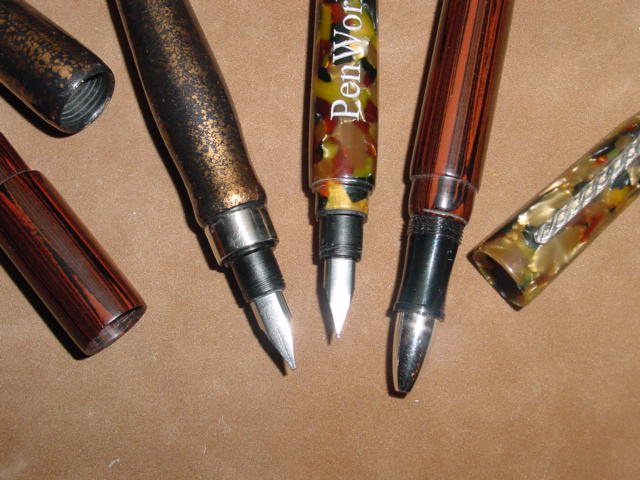

I have been experimenting with press fit caps. I think a good press fit cap solves a problem we experience to often. Customers pull when they should twist, or twist when they should pull[xx(]
Here is 3 different materials I have tried this with, A steel bushing, resin & ebonit. They all work! But it is time consuming and hand fitting. Bruce brought this up just now. If there is a way to mass produce the right press fitting it would be nice.
The ebonite material works the best using the press fit method, as the material being a rubber base(I think) gives it a little stretch and feels good mating with the nickle bushing.
Just some food for thought. What do you think Bruce? There has to be an easier way than by hand fitting. Also, there is a pic of the sterling silver clips I am working on [8D]

Jim, I think the press fit cap is a better seal. Haven't water tested it though. If your FP leaks that much through the cap, I would say you have issues with the feeder and not the cap. [:D]

The middle pen that has PenWorks on it, I have been using since I completed it. Everytime I uncap it, it writes, even after a day or two. The neck pen I made myself where I had to drill a hole in the cap for the jump ring, dries out in minutes. So a good seal does make a difference. I have to CA that hole shut and hope that solves the problem.
Anthony, are you not using the threads on the ebonite pen? I wonder too, if you were to coat the inside of the cap with something like rubber cement (not thick, mind you), if that would give you a positive enough seat for a wood pen (and maybe help reinforce the wood, too).
Jim, if you look at the black painted ebonite pen, you will see it is threaded. Well it was a botched thread job, that's when I started tinkering with the press fit cap idea. I finally found a good use for the black CA Daniel sells [:D] Rubber cement might work, but you are going the way of hand fitting it. I was thinking on the lines of what was brought up last time we when we discussed threading. Some type of nylon or derlin bushing, something with a little flex to it.
