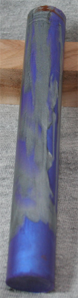

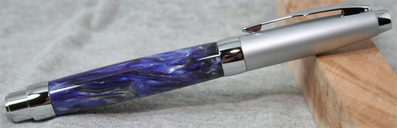

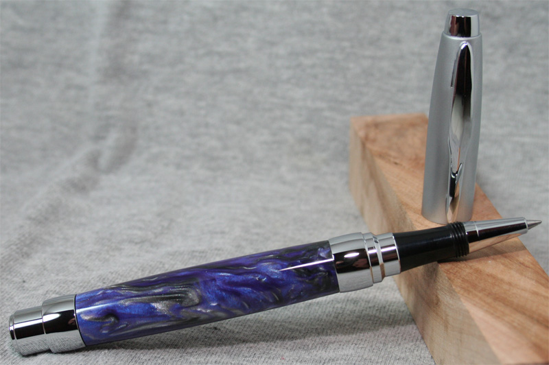

this is a thank you to my wife for letting me use the shop for a couple days of my time off from work (her side of the garage :biggrin:). it's a Presimo from PSI with one of my first casts. She seemed pretty happy with it! I included a pic of the blank before turning for comparison.

that is a pretty cool looking blank. Alot better than my first one. my wife wants me to try one of those kits
Pretty cool turning through a fresh blank that looks, well sort of ho-hum to find treasure!
What did you do for a finish, MicroMesh? MM and more?

Thanks Scott! It is a lot of fun to see what is hidden inside the blanks. I have a couple more glued up and ready to go that I'm excited to see.
For finish, I ran through all the MM pads, then HUT plastic polish, and a coat of Turtle Wax ICE.
I like that cast a lot! Is the pen overturned or is it just the way it looks with the round kit?
Thanks! To be honest, I think that might be the design of the pen. I turned the blank slightly proud of the bushings, and it was still slightly underneath the kit components. Looking at the PSI catalog, their example pens look the same. Either way, for the next one, I'm going to caliper it and match the kit parts - I think it looks overturned as well.
Since I couldn't edit my previous post, I have to do a new reply - but I wanted to follow-up on my earlier response to jason.
The pics on PSI's site show the blank turned right up to the hardware on the kit, not slightly under as I thought I remembered. So yeah... I overturned this one! Looks like I'll be using the calipers for the final 3 kits, just to be sure. I did turn it right to the bushings, which I've learned is a 50/50 shot concerning the final fit of the components.
