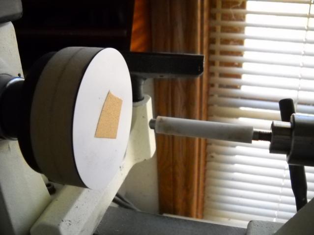

I use a sanding jig: MDF with plastic laminate on faceplate and shortened pen mandrel in the tailstock. Use milling sleeves for each kit blank to ensure the ends are square. The abrasive is a small piece of 120 grit PSA sandpaper.

I use a similar setup as JimMc7. Only difference is I use a jacobs chuck in the tailstock with a HF punch to hold the blank. I don't use a sleeve as I just hold the blank against the punch and slide it towards to sandpaper. Works great.
