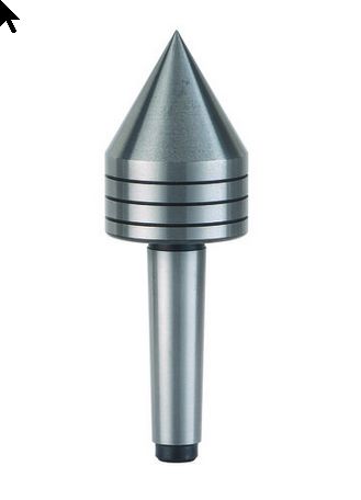

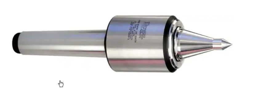

Mike, I believe you are referring to my comment about a CNC live center. There are several styles of live centers depending on use. Most lathes come with a live center, but the point is sharper (more pointed) than 60 degrees. For most pens mandrels use a 60 degree live center like the first photo. But the sides of the center get in the way at the end of the blank. So I use a live center intended for "CNC machines". It looks like the second photo. This keeps the sides away from the end of the work. BUT they are very expensive! There are also live centers with replaceable tips. I would go for the one with replaceable tips.
