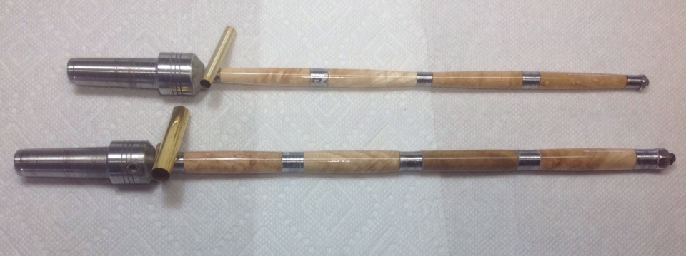

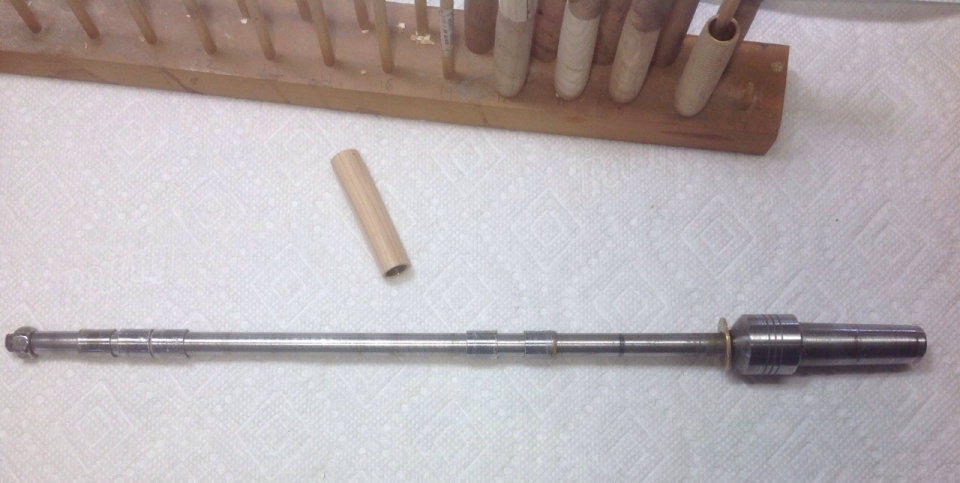

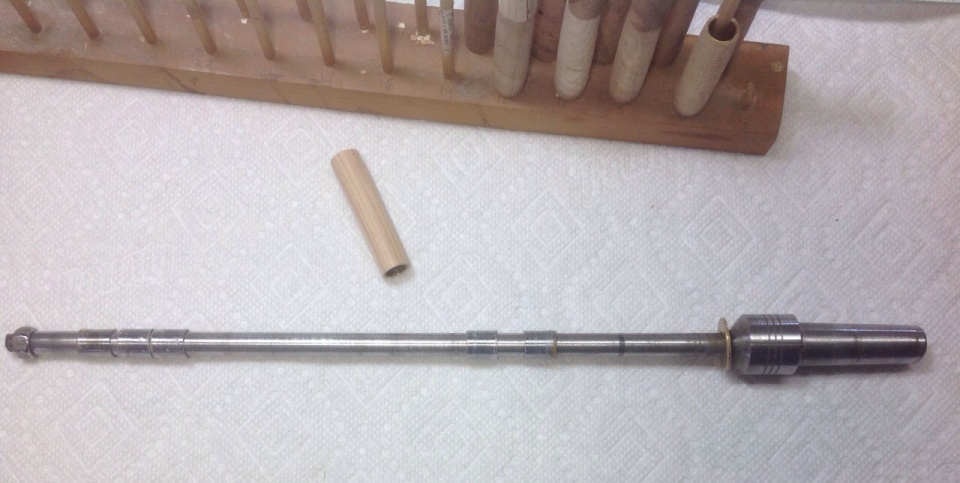

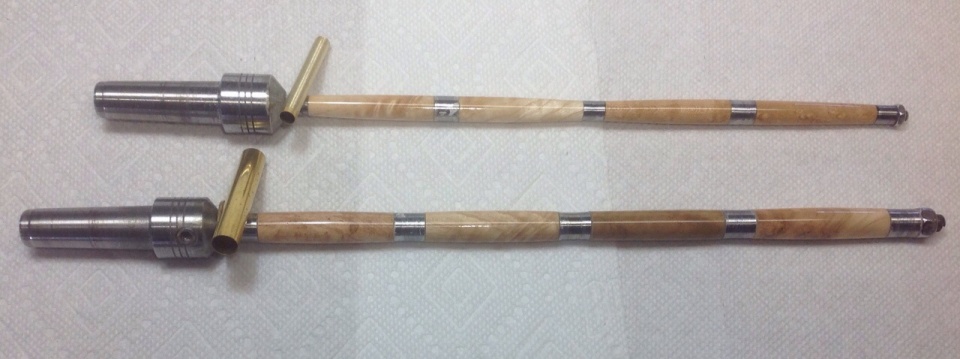

Mandrel
I've turned with this for almost 4 years
Any machine shop would be able to make those for you. The mandrels are just properly dimensioned rod that are threaded on one end.
The rods will also need the end machined to accommodate the live center. Still any machine shop should be able to do this.
