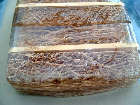

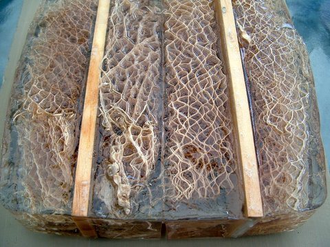

In the last week I have had a few emails inquring about the cactus pen I showed last week asking if I used epoxy or PR. I used PR and had only cast one blank at a time. This morning I cast 4 at a time in a tupperware type container whick was divided in the middle and used a paint stirer to sub divide to make 4 blanks each blank being 5 7/8 in long x 1 1/2 wide x 1 1/2 deep. My thinking that each blank could be then divided to make one large pen and one slim or 4 slim lines. The 2 blanks at the end are slightly larger. My next pour will be in the same type container w/o the dividers and than cutting the blank to size.

How did the single pour( no divider)go?

MESSY? NOT FOR ME [:D][:D]I JUST LET DARIO DO THE DIRTY WORK FOR ME![}:)]I JUST HAD TO DARIO, SORRY LOL!!! RUSS IN ANSWER TO YOUR QUESTION ABOUT THE SINGLE CASTING ,I'VE NOW CAST ABOUT ENOUGH FOR 12-15 BLANKS AND ITS WORKING OUT GREAT. I PLAN TO TURN SOME THIS WEEK END AND I'LL POST SOME PHOTOS. IN ANSWERE TO THE QUESTION ABOUT THE SIZE I'M CASTING 1 IN. THICK X 6 IN. SQUARE. DARIO BTW I TRIED DYEING THE CACTUS BLACK DON'T TRY IT. SEEMS THE SKELETONS DO NOT ABSORB THE DYEquote]Originally posted by Dario
