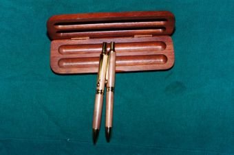

Here is one of the sets I made in Cedar. I guess I'll have to work on the photography.
ATTACH]
Greg, from what I can see they look good. I hope you have better luck with your click pens then I did. They don't seem to hold up very well for me.
Personally, I didn't like turning Cedar. It turned like butter but I kept getting tearouts at the ends of the tubes. I tried everything I could think of. CA on the ends didn't seem to help. I made sure my skew chisel was sharp. Maybe I just need more practice with it.
Greg, I'm not an expert by any stretch. I have some cedar that I got as part of a bunch of blanks I got on eBay. It turned great, and didn't tear out on me at all. The one thing that I've learned, and that I did with the cedar, was to always cut from the middle out, rather than the other way around.
