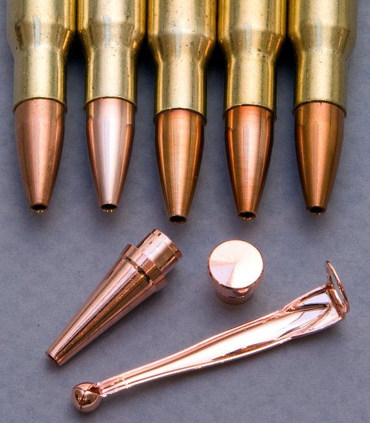

Is there something about the Columbia powder that protects the copper against heat discoloration? I find that I get "bronzing" (for lack of a better term) even when I put an uncoated cartridge in the curing oven for 8 minutes at 350(+/- 10) degrees. To illustrate:
From left to right, (1) a bullet right out of the box, (2) a bullet that has been polished to match the copper pen parts below, (3) an uncoated bullet that was baked at 350 for 8 minutes, (4) an uncoated bullet that was baked at 350 for 10 minutes, and (5) a clear-coated (eastman high gloss clear) cartridge that was cured for at 350 for 20 minutes after flow-out (also at 350).
#1 is not bright, but is copper color. #2 is bright copper color. #3 and #4 have taken a bronze tint - and unevenly so. #5 has a slightly more pronounced tint, but the coloration is even.
Given that the heat alone causes the color change, I'm skeptical that a different brand of powder would change things. I am, however, willing to be convinced if Columbia adds some sort of corrosion-inhibitor.
Now, I'm sure I could still sell a pen with a tinted bullet, but I'd like to be able to pair a powder-coated cartridge with a copper kit (and have them match). I'd hate to have to drop back to brass lacquer, which is far less durable than powder paint.

NOW I see what you're trying to do. I THINK the answer is, no, you can't powder coat bullets and expect them to stay the exact same color as copper pen parts. I don't know if the pen parts are real copper or just copper colored. You might try powder coating the bullets with a copper powder, I don't know. I don't use copper pen parts so I have never ran into this EXACT problem. The problem I was having seemed to be much more severe than what I can see in your photos. I still get a little discoloration but I can live with it seeing as I'm not trying to "match" a particular color.
