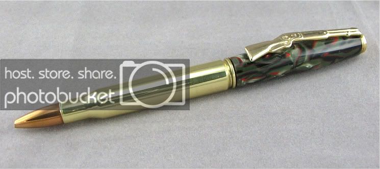

Here is a quick photo of what I was talking about. I forgot I too have switched to the high temp corks instead of the tin foil on the top any more. It has been awhile since I did much in my shop let alone any powder coating. The rack on the right has pop rivets in it instead of the bolts because I use that to powdercoat my cartridges which as the bullet in them already and I do it all at once. Thus the need for a thin item for the refill hole. These work out well. I have several made up so as some are cooking I am powdercoating others and the assembly line can continue. I do not usually do alot but you can very easily. Just my way of doing things.

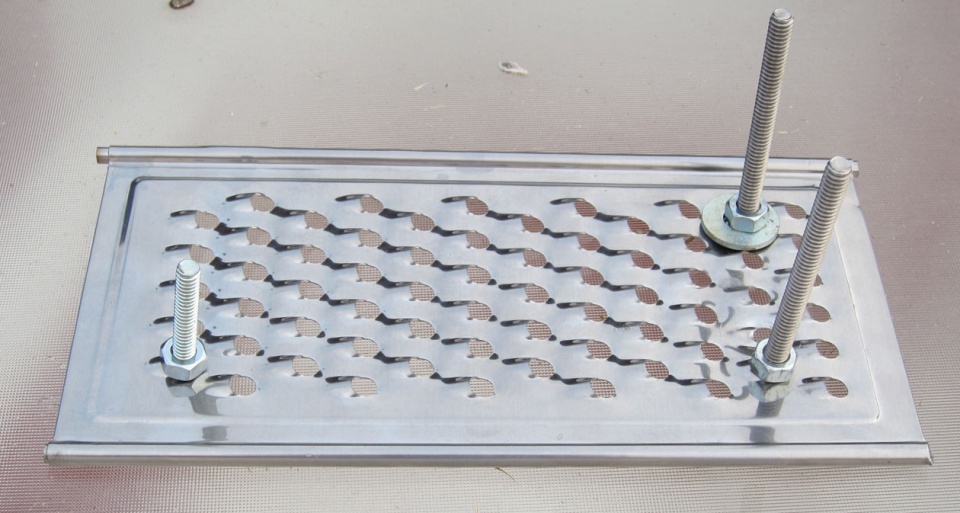

This is my yet to be tested solution.
I wanted something that was low profile that could fit into an toaster oven so I used a cheese grader. No hole drilling, easily adjustable for number and sizes of tubes, and all metal. All I needed were nuts and bolts.
This was based on a great video by Seamus.
