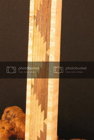

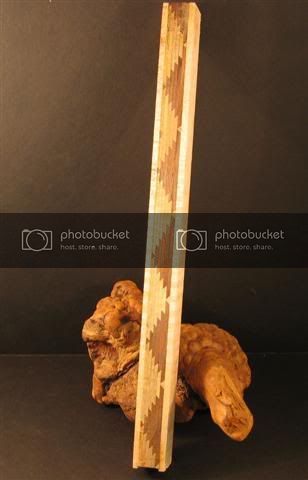

What do think of this? It is 3/4"x3/4"x10" long and has 72 pieces maple and walnut. On the solid maple sides I was thinking of drilling a diamond shaped hole and inlaying some turquoise in the finishing stages.
I have another drying right now made with ash and mesquite where the triangles are closer together.

Well, I have not really given that part any thought yet[:0] Kits on hand are slim line, round top european, cigar and baron. The width between the valleys will make placement of the cuts picky. That is why I made the second blank with smaller valleys. My usual M.O. is to make the design then make it fit[:D]

<br />How thick are the pieces that compose the "pyramids"? The "sides"?
The pyramid pieces are a hair over 1/16" and the sides are at 1/8". An atlas maybe the one to experiment with. I forgot I have a couple of those kits too. Not my favorite.

Actually I'm thinking that the outside 1/8" pieces will not come into play at all. If you cut and turn as is it looks like you will end out with very little design on the left and right side and multiple stairs steps in the middle. If I may make a suggestion? What if you cut this blank into pieces that are white segments and then cut some that are brown segments and then flip them onto each other tip to tip? Then turn.
If this just doesn't make sense e-mail me off line and I'll elaborate. Myself I would go with the Baron kit so that you have more of the design exposed. The cutting options on this blank are endless and I look forward to seeing the completed pen!
Well good news and bad news. Good news is my old sander looks new! And there was enough meat to have the design turn out on an Atlas kit. Bad news is even though I plugged every hole on the motor before sandblasting I did not cover the switch. I now need a new $5 switch. On the pen I decided to try freehand drilling some inlay holes for turquoise. 5 of 6 holes are good. The bad one is because the drill bit took a walk. Even though I pre-drilled [V] It is now hidden as much as possible under the clip. I'll post some pics after dinner.

Ron were you meaning going from this /\/\/\ to this &lt;&gt;&lt;&gt;&lt;&gt;?
