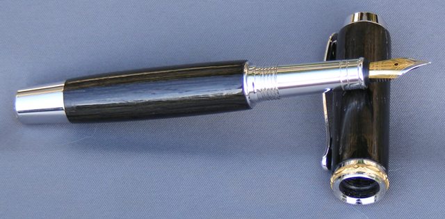

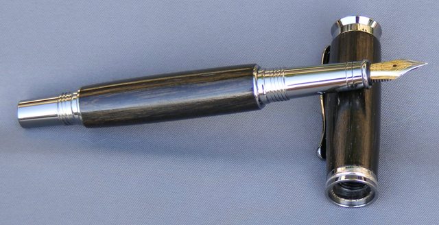

Here are pictures that show both types commonly available in kits.
Notice how one has threads on each end of the pen for the cap to screw onto, while the other only has threads on one end.
the postable type is more forgiving, since if you are slightly proud of the trim band, its not too noticeable. On the non-postable the junction between the blank and the hardware needs to be much smoother since it tapers, being proad is very noticeable.
