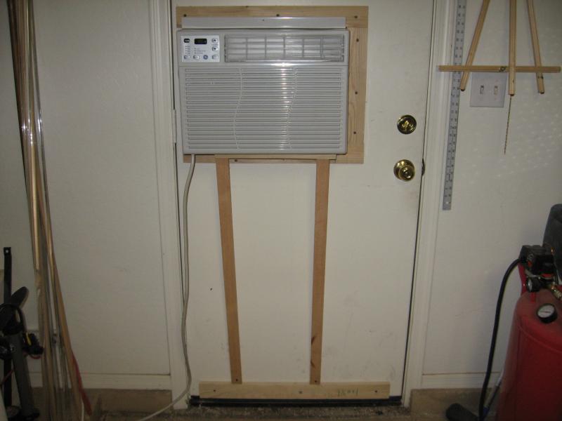

I was looking at those as well for my garage. Living in AZ its have an AC or dont work in the shop(Garage). I didnt want to cut a hole in my wall but I'm ok with replacing a door someday if need be so I did this. Put it in today and it works amazing. 12000btu for a 2 car garage. Seemed like I could get alot more for my money with the window style vs the portable. Just thought I'd share.
