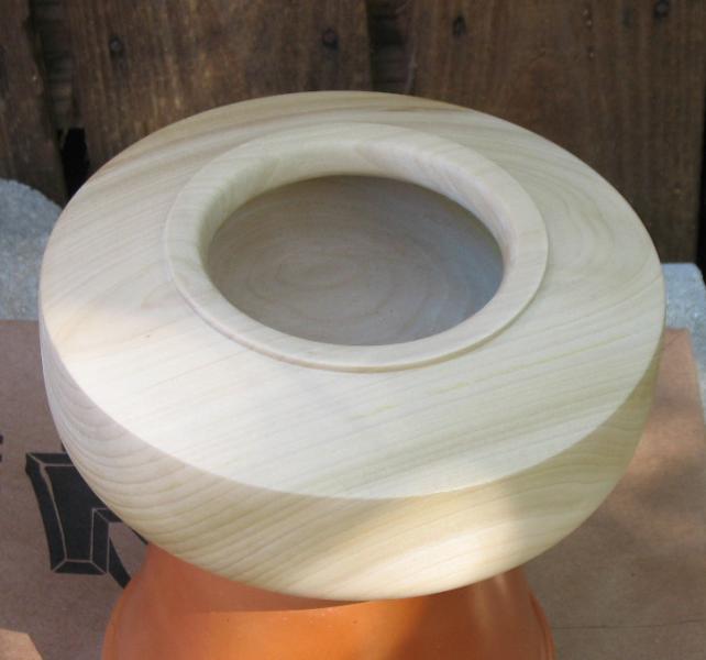

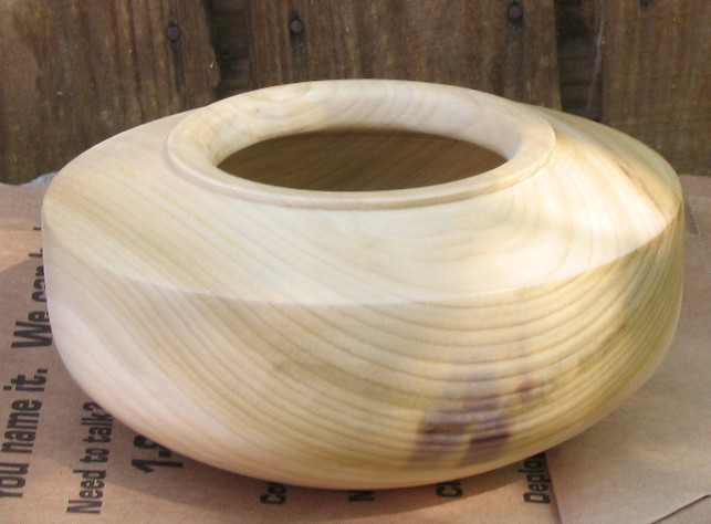

Poplar Bowl with just sanding sealer, worst than pine to turn.

That is really pretty. Having never turned anything but hard wood pen blanks and PR blanks I don't know what you mean by "worse than pine" I was wanting to start turning other things, so I want to learn all I can.
Poplar a hardwood is as soft or softer than pine. Fingernails sink into this stuff leaving indents. You need to sharpen bowl gouge more often than with most other hardwoods.
Many woodturners refuse to turn poplar or pine. Torn end grain, fighting early –late wood can drive you nuts. Sharp tools, tool control, and light touch required to get smooth finished surface.

That is very nice... I really like your shape... I have several bowl blanks in poplar to turn and have done several goblets from a poplar 4x4 that was used as skid for the laths when the contractor put the new metal roof on my house.... I kinda like it to turn.
Try white cedar sometime... it's as fuzzy when you finish turning as it is when you start... no mater how sharp I had my tools, the wood came out fuzzy.... sanded okay though.
