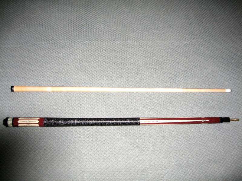

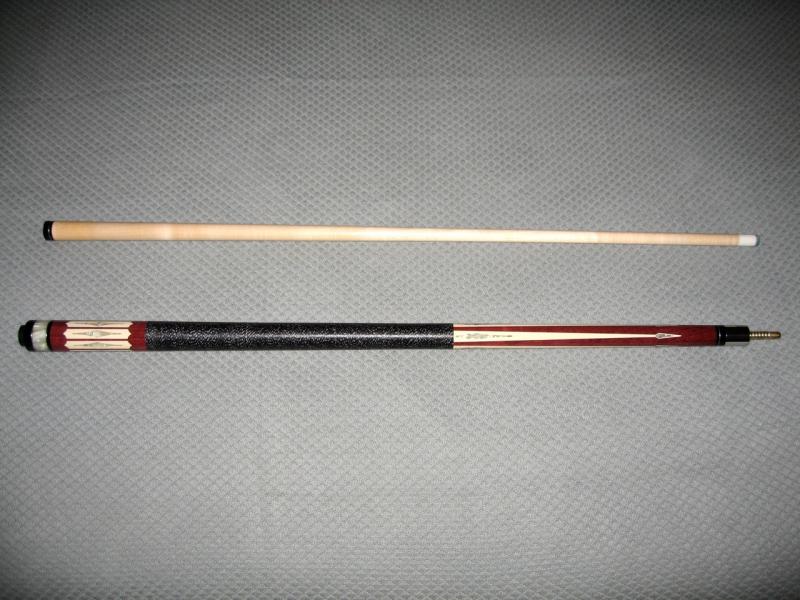

Well here is the pool stick. I need to take the essence of the design and make a pen. There has been allot of verbiage that I will read tomorrow. Some very good stuff.Xcelerate Pool Stick 1-30-10.jpg
What type of pen are you going to try to make for this?
Paul
If you are talking to me, I am going to be making a closed end 2 piece pen Probably using a baron kit or something on that sort. Whatever pattern you post I should be able to size it accordingly unless there is something I am missing. I might be able to even use the cigar guts for it. Have not given it too much thought. Thanks.
