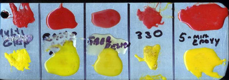

See the thumbnail of my test panel for assorted epoxies, and adhesives. When I was looking for a material to be poured into pewter belt buckles. The dye is the pigments for castin craft resin opaque type.
