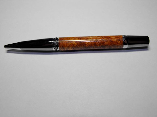

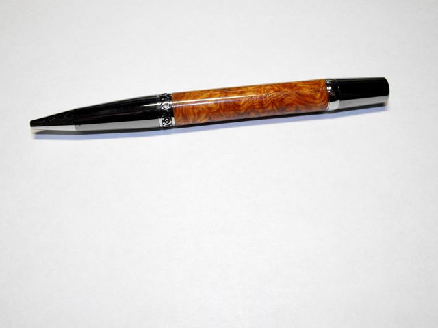

Here are a couple of picture of the pen in question. This is my first time trying to post a picture so I hope this works.
John
If the "pits" look kind of like orange peel, I've had that problem on afzelia and amboyna burl finished with minwax poly (I use Les Elm's technique, which can be found in the forum library). I tried a couple of coats of zinsser seal-coat first and it helped a lot.
But... I think Marc hit the nail on the head: too much sanding at the start and not enough sanding at the end. I use 1500MM after the seal-coat just enough to smooth things out and only between the first couple of coats of poly if I think it needs it. Personally, I think 600grit is too coarse.
After two coats of the seal-coat and six coats of the poly, I start sanding at 1500MM to rid the pen of any remaining depressions. But be careful here. If your coats were too thin, you'll go right through all six coats. I also noticed that if there are depressions left after getting to 12000MM, they'll be accentuated when you use the brasso. So when I start, I sand a few seconds, stop the lathe and check my progress, and continue until it has evened out. Then I continue through the remaining MM grits.
On the other hand...
The seal-coat and poly technique also works quite well on porous woods. If you don't want the pores to be filled, don't slurry sand with the sanding sealer and don't use the brasso, which will fill the pores even after the poly has been applied. I just assembled a Gatsby made from Bocote and finished with two coats of seal-coat and two coats of poly. I lightly sanded the seal-coat and didn't sand the poly at all. In fact, I didn't even polish it with MM prior to assembly. It's beautiful, very shiny, no orange peel, and you can see and feel the pores... a very natural looking finish. I think this particular pen may have had a little help from dumb luck though. :biggrin:
Paul
Suggestions from a fellow TN. penturner
John,
You've got a good start on good taste - amboyna on BlackTi-Platinum Elegant Beauty Sierra.
With your blank, it looks like it's actually narrower in the center of the blank. If you don't put a slight bulge in the blank, it's going to look narrowed, even if it's straight across in diameter.
With a Sierra, the bushings are .474 usually. Take your blank down to .481, and about .512 in the center, or even 2/3rds up towards the top of the pen.
If you don't have a digital caliper, get one. They're about $17. at Harbor Freight and are crucial for accuracy.
Also pick up the Harbor Freight 5-piece Long Punch set for $6.99. The largest punch in the set is perfect for disassembly of a Sierra - stick the punch into the blank and give it a rap and the top of the Sierra pops right off.
The punch is also great for cleaning glue out of the brass tube - apply pressure to one side of the tube and any remaining glue gets sheared out.
And...finishing wood is The challenge. Try some acrylics once in a while to increase self-worth.
Bruce in TN. (Fayetteville)

John , I have been looking at those pics and the spots I see are in the wood . I think it's just a question of better prep work . The sealer coat , no matter what you use , has to fill all the imperfections in the blank . From what I see the pits are along the grain lines and are probably due to cracks or voids in the wood that just wern't filled all the way in .
Thanks Butch for your evaluation. Since I've only been turning pens since around Christmas it's nice to have more experienced eyes critique my work. I will try and work harder on my prep work next time. The problem is that it is easy to miss things until you start building the finish and problems start to appear that you didn't see before. The important thing is I'm having fun while learning.
John
