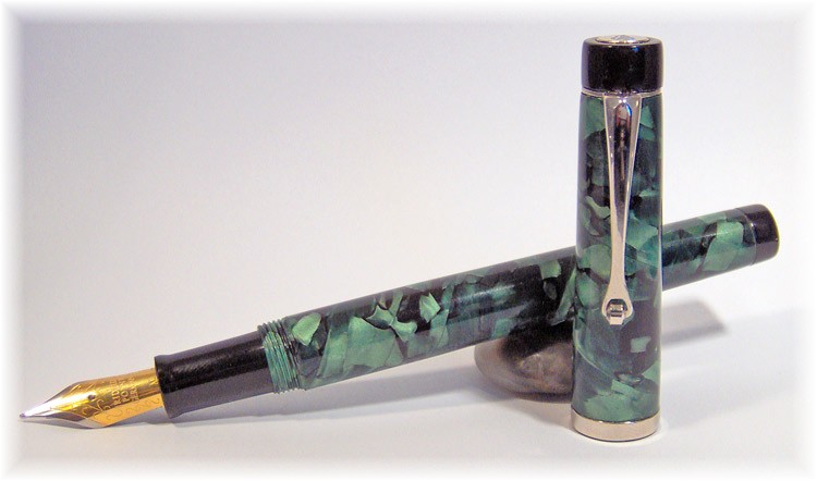

I use wet and dry, starting at 240 and work my way up to 2000. I protect my lathe bed with paper towels and sand with water, to keep the Celluloid cool, lathe spins at about 1000 rpm to stop the Celluloid scorching. After sanding I use a soft cloth with Hut plastic polish keeping to 1000 rpm. Finally on to the buffing mop and spin the mop at about 1000 rpm,then coat of Ren wax job done
