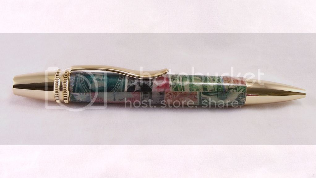

Another pen I made yesterday. This was not cast. I turned a piece of maple down just below the bushings. I sanded it to 220. I downloaded a bunch of pictures of old stamps. I used photoshop to rotate and place each stamp to look sporadic. I printed out an entire sheet of these stamps on paper. I sealed the ink with spray lacquer. I used a glue stick to paste the paper onto the turned maple. Once I got it the way I wanted, I sealed it in with a lot of coats of ca glue.
