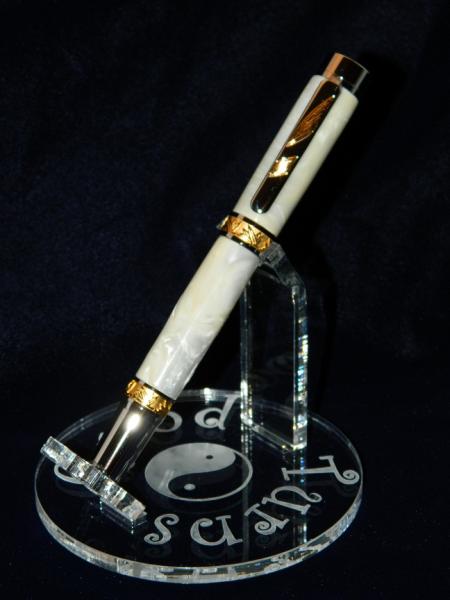

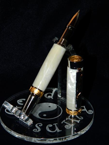

Got my first chance to try celluloid...if you get a chance, DO IT! Not a bad pic, but the depth and motion in this material is wonderful (and the shop smells pretty neat too!)
(thanks to Charlie for the cool new stands, too!)
