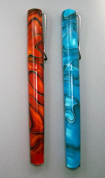

Lets start with the most direct comparison I could find in my collection. These 2 pens are of the same design, and the caps are almost identical in size. You can see that the blue pen has a longer body and overall length than the Orange pen. Disregarding color, which has the more pleasing proportions?
There is some invisible text below. If you high-light it with your mouse, you will see which one follows the 2/3 rule.
The orange pen has a cap that is 2/3 the length of the body.

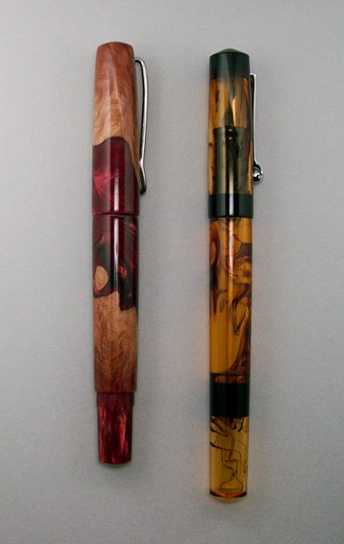

Here are 2 pens that don't follow the rule. The body is too short on the red one, and too long on the Ancient Amber pen.
On the ancient amber pen, I always had a feeling that the black band on the blind cap was a bit thick, but I left it as is because it is hiding the threads beneath it. After taking all the measurements today, I found out that if I left everything else the same, but reduced that black band by~ 3/32" then this pen would me much closer, and also the blank band would end up being about 1/3 of the length of the clear portion of the blind cap.

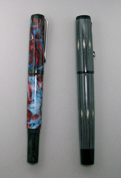

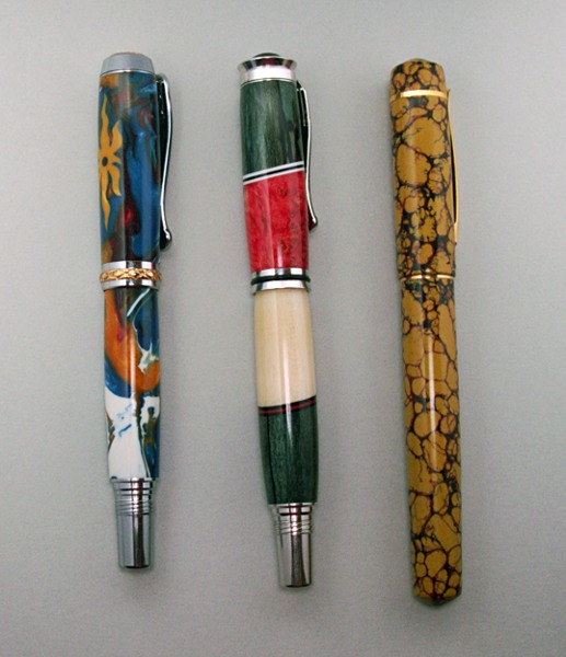

Let's take a look at some kit pens. This picture shows, from left to right, a Triton, a Jr. Victor, and a closed end modded Church Hill.
Note that when I took measurement on these I used the center of the center-band instead of where the body & cap joined because I thought it to be more of a visual focal point.
I really like the styling of the Triton kit, but the body simply looks out of proportion to me. Taking the measurements, the body would need to be 1/2" longer to make the cap 2/3 body length.
The Jr Victor kit is more typical of the length of other Jr. kits. I think the longer body make a more pleasing proportion, but it is still too short based on wanting a cap 2/3 the length of the body.
The Church Hill is very close to the proposed ratio. (The body is only about 1/32" too short)
If you like this ratio rule, adn want to make a closed end Jr. pen, I think a body length of 3.25" will be very close to these proposed proportions.
