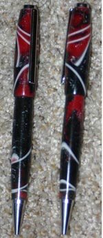

I don't think I've posted this pen yet. The colors were done using India Ink as the pigment. There is a little luster powder that I wish I had left out this time. Cast using pressure paint pot...no air bubbles anywhere [8D] I have some snake skins ready to cast tomorrow. I'll show that casting whan I take it out...maybe even a pen the next day...or maybe to the trash...we'll see. Enjoy and comments always welcome.

Your casting technique for these pens were great. I like the designs that came out.
Very nice pens. WWWhhhhyyyy hasn't my pot come yet ?? [:D]
Thanks for the comments. The white swirls are not caused by the pot. All the pot does is allow pressure to be introduced and squeezes any air bubbles so small that they can't be seen...no voids, no bubbles...As for the swirls...I'll share when the process is a little better perfected. Actually someone else has shared the process and it went by without being noticed by most of us. Three of us and possibly the original poster are working to perfect the process and when we are happy with the process we will share... and about pressure casting also. Waiting is such sweet agony[:D]
