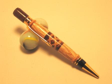

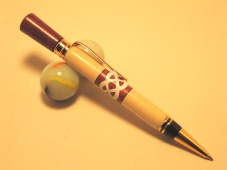

Decided to do a couple of knots.....but a bit different for me.
The first on is done with Holly,Purpleheart,and Pick Guard. The body is Holly, the knot is pick guard in a field of purpleheart and the finial is purpleheart. The finish is a simple friction polish. The kit is an Executive.
The second is done with Red oak and Walnut. The body is Oak,the knot is oak in a field of walnut. The finial is also done in walnut. Finish is CA topped off with Ren. wax. The kit is an Executive.
Those are really cool!!! I like the way you inlayed the knot into a different wood... And the custom tops are GREAT. Was there any special trick? I have a few executive kits and would like to try that.

Dean, The only trick I suppose was to use an 8mm tube for the finial,the inside dia. is a perfect fit for the transmission of the Executive. :biggrin:I did not have a bushing to match up so I just used calipers to get the proper fit.
Hope this helps, if you have any questions let me know.

Nice pens. I like the different inlay for the knot also. very diff. What are you cutting your kerf with to match the pickgard thickness. I've thought of using aluminum but blade thickness is the question. A thin kerf TS blade is still thick for pens. Even band saw blades don't match. Thanks
Richard, Thanks for the comments. The blade that I use is a 7 1/4 Stehle. My son sells tooling to the furniture and cabinet industry and he gave it to me. The kerf is the thinnest that I have found and fits the single ply pick guard perfect. However the multi-ply pick guard is too thick. I use it in an old Ryobi TS that I have. The blade I think is made in Germany and is for a circular saw. Hope this helps.
