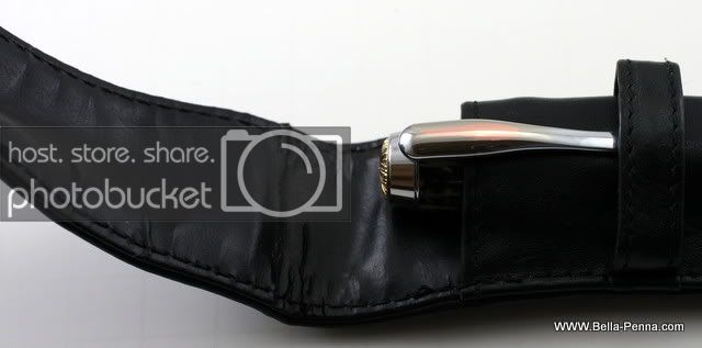

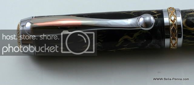

Anyone else have this happen? Andy Little and I talked about this a few months ago, maybe a little longer and I had forgotten about it as I just didn't add the componet set to my inventory as it looked too much like the Jr. Statesman and I'm satisfied with the Jr. Statesman . Actually Andy sent it to me to try. I made it and gave it to my son in Ft. Worth along with the leather pouch pictured. Last week he and the family were up to visit he showed it to me and said he always kept it in the pouch covered when not in use. Where the cover goes off and on it rubs the clip and the result is the wearing off of the chrome as pictured. He left it here and today or tomorrow I'll replace the clip with a Jr. Statesman or Jr. Retro clip, I think the clips on the Triton are the same size.

I had a statesman that I carried in my pocket (pants, jacket, anywhere I could stuff it) for a couple of years. It was rhodium plated and it wore off too. I figured it would not have mattered what plating or how thick...that environment was just too abrasive.
If the pen is placed in the leather pouch as shown, any plating is going wear off if rubbing is localized as it seems to be. We all know how thick the plating is on the pens we make. Chrome is up there with the best of durability.
Brian, not to get into the ware-ability of one plating vs another (we've been down that road) as this could be just one of those things but I have been caring a Jr, Retro Gator in the same type pouch for a little over two years and no sign of ware at all. I carry it in my front pants pocket and use it daily, this one is six months old and my son keeps it at work in his desk.
