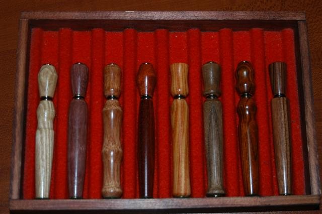

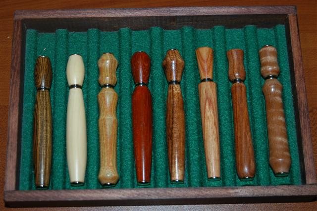

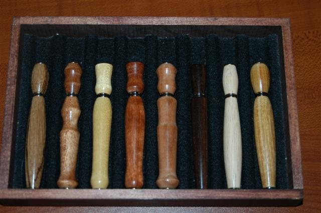

Perfume pens are 50% of my turning and sale. There is very minor difference between the different manufacturer (mostly about the tip being a little smaller on the Berea one). They all use the same bushing and tubes. I take mine at Berea $3.60 if you buy one but the price drop at $2.50 if you buy 10. I buy them 60 at the time and pay $2.00 each. They sell very well, specially with older woman. Watch for Mother's day coming up, i usually sell 50 and of them just at the office.
Alfred
Edited to add: I never add any problem with the 24k gold etheir in 3 years selling them. And if you want models idea:
<br />
<br />
<br />
