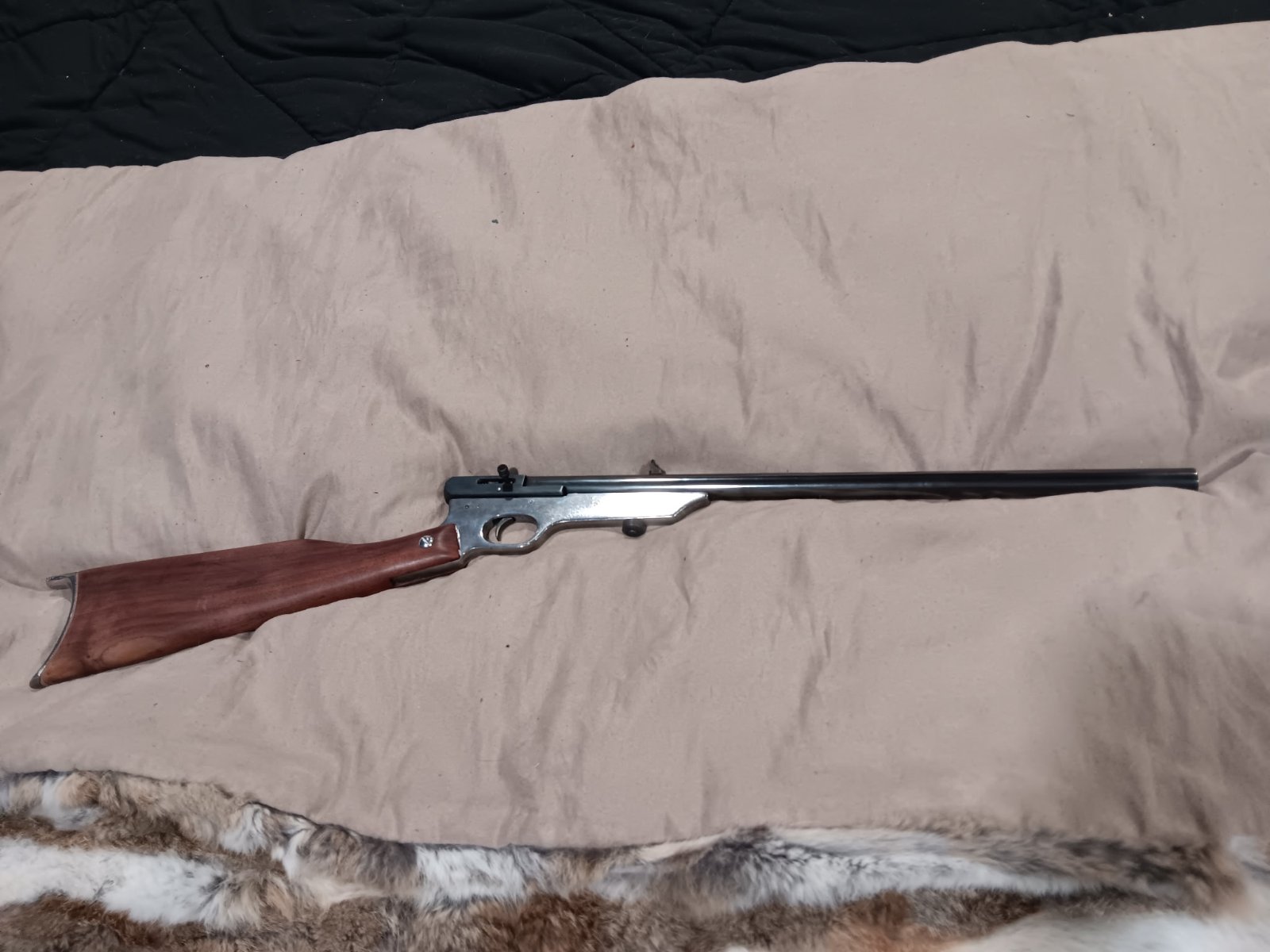

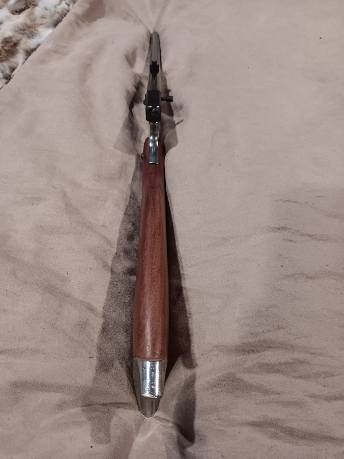

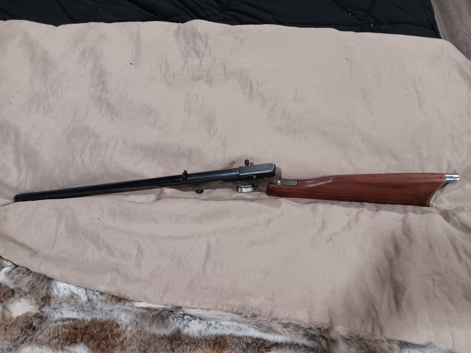

It's not hard according to everything I have read and the watched... just paint the part in conductive paint, then plate it. Metal is easy-peasy! I redid a quackenbush safety rifle i got off gunbroker for $50 shipped that was in rough shape. I found missing parts, made a stock, and replated the receiver nickel and blued everything else. It took forever getting the rust and pockets out and sanded polished cleaned, ect. I made a jig to suspend it and spin it slowly in the solution too. I also plated the buttplate but didn't put as much effort into it.
