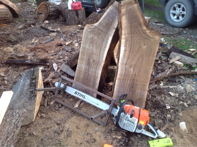

I mill a lot of lumber with a chainsaw mill I made. I feed it all to that Dewalt so it's had a workout over the years.

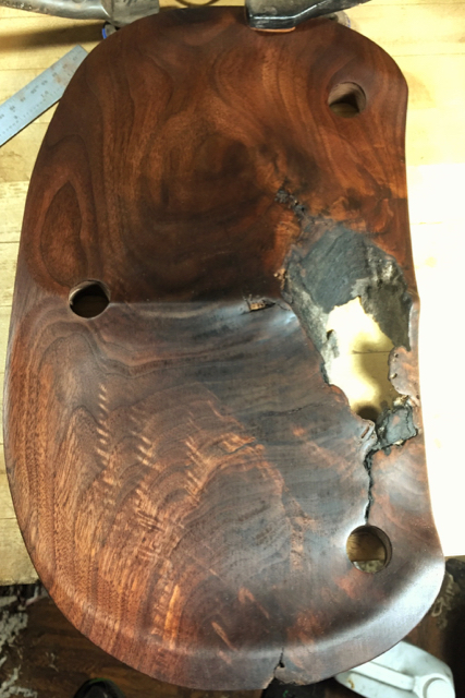

Here is some Walnut crotch wood I chainsaw milled then planed with the Dewalt, the two speeds and ability to easily change blades become important when you deal with wood like this.
I'm guessing you have the DW-735 planer because the DW-734 doesn't have two speeds as far as I can tell.
I would love to have the 735, but just can't justify the extra price at this time given the very limited amount of planing I do or will ever do. Even with this 500 bf of walnut sitting in the garage.
Yes, I have the DW-735. Thinking back I'm at closer to 15 years with it. I know $150 more is a lot of money. I would save up and spend the extra money. The two speeds will come in handy when you find that wood that will make perfect blanks. Even on the slower feed rate which gives you more cuts per inch you can get tear out. Then I switch to handplanes. If I wanted straight grained boring wood I'd use MDF.

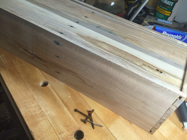

Rough lumber is everywhere if you look. Here in the Midwest most of our pallets are hardwood. I feed those to my planer too. Motorcycle shops that import bikes have pallets made out of bizarre woods we don't have here in the states.
I use a metal detector to find the nails.

You don't need a chainsaw mill to cut rough planks, it helps but is not necessary, a chalk line will mark the slabs out for ya.
