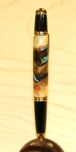

Since his pen was delivered yesterday, I can show off my SYP PITH pen I made for Scott. I was a bit intimidated after seeing pics of pens he has made, and he has been turnig for a long time!
This was my second ever sierra type pen. (The first one was a dry run for the PITH) It is a SYP knot infilled with crushed turquoise on a Ti Gold/Ti Black Le Roi.
